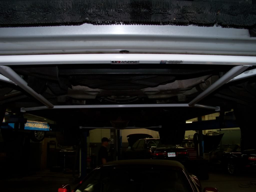

I have Arden springs all around. The only shimming involved the rear camber & we used factory shims. I have had the springs for about 6 years as well as the poly bushings, the Ultra Racing braces have been on about 2 years.

I think the rear sway bar is smaller than that. If I remember correctly the rear bar is smaller on the coupe as well. I can measure my old one as it is sitting on the floor at the shop. My car is an XKR so the top brace would not fit my car but I still think it makes a small difference.
Attached Thumbnails lowering springs vs larger rear anti-roll and lower frame braces-003.jpg   lowering springs vs larger rear anti-roll and lower frame braces-001.jpg
