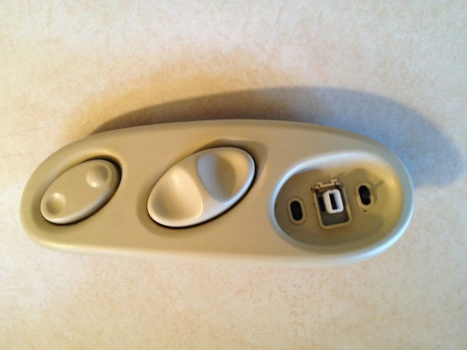

My passenger seat was missing one of the buttons. worked fine but no button to move seat front to back. Found a used one for $85.00 from a local yard. went to get it and he told me how he quoted too low a price but would honor my price. Next day he had the drivers side on ebay for$185. My point, is there a way to buy a button so I have the extra switch.

The only way to get a button is to salvage one from an intact switch. The bigger problem is there is a piece of spring steel back there also, to keep everything in alignment as the button moves. That piece is usually lost if the button pops off. Then you are in a pickle.
Cheers,
