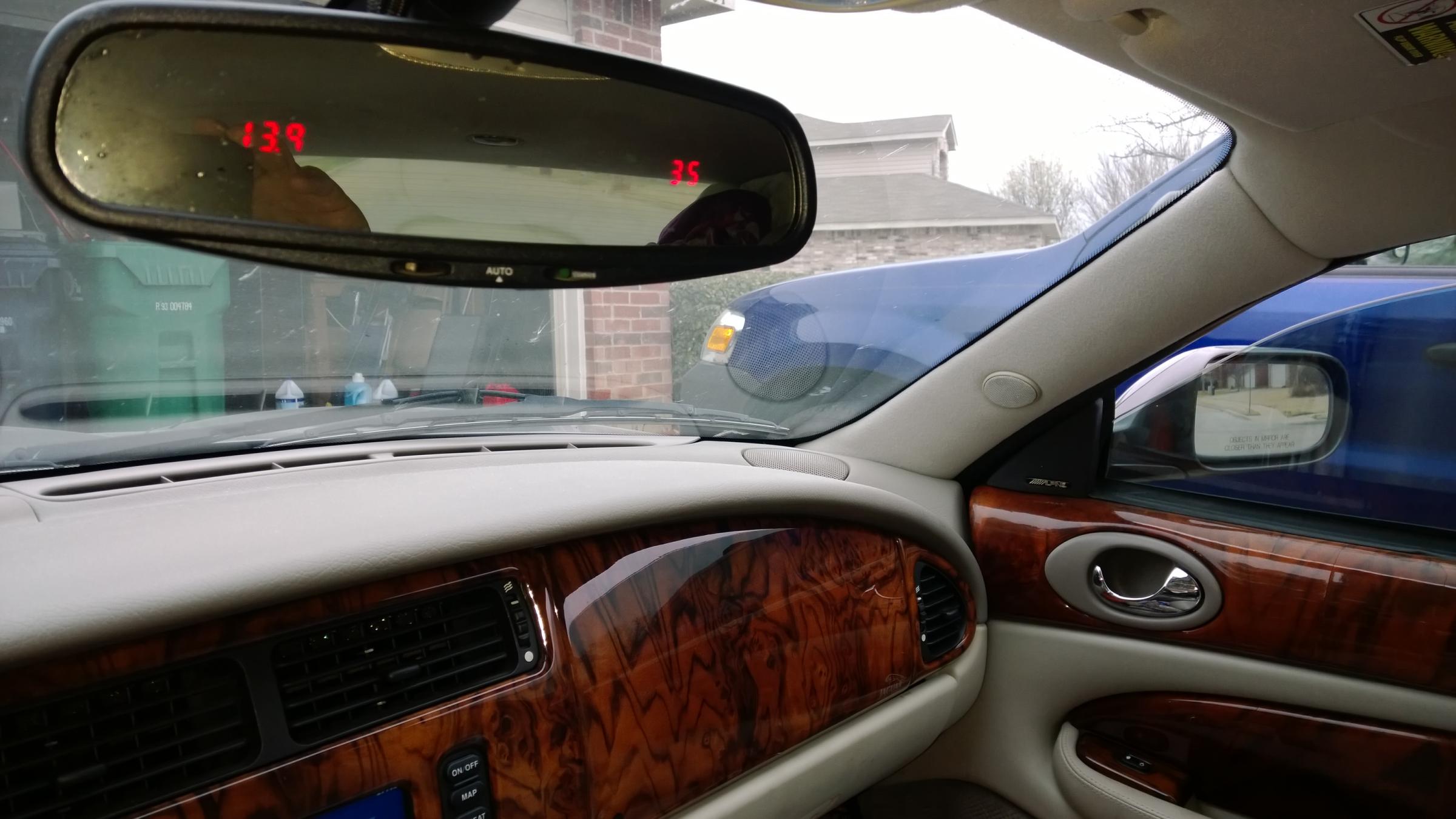

mjlaris, thanks, how about interior pics: walnut panels, your dash...

Originally Posted by weisberg
mjlaris, thanks, how about interior pics: walnut panels, your dash....
I don't have any good interior photos at the moment. After I had the door cappings and inserts installed, it made me realize how much the rest if the wood dash had faded. I then had the rest of the dash restored so now it matches fine and looks great, at least in MHO. However, 5 days after getting my XKR back I started having chest pains and 4 days later was on the operating table for a triple bypass. Just as I was starting to feel better, my fuel pumps failed. My car us currently with the Jag Dealer getting replacement fuel pumps installed under my extended warranty. I should get it back this coming week and will then take some interior photos for you.

Here are the photos I promised.
Attached Thumbnails LSD but leave rear axle ratio same? How about opposite-wp_20140322_17_50_28_pro.jpg   LSD but leave rear axle ratio same? How about opposite-wp_20140322_17_49_11_pro.jpg   LSD but leave rear axle ratio same? How about opposite-wp_20140322_17_47_43_pro.jpg
