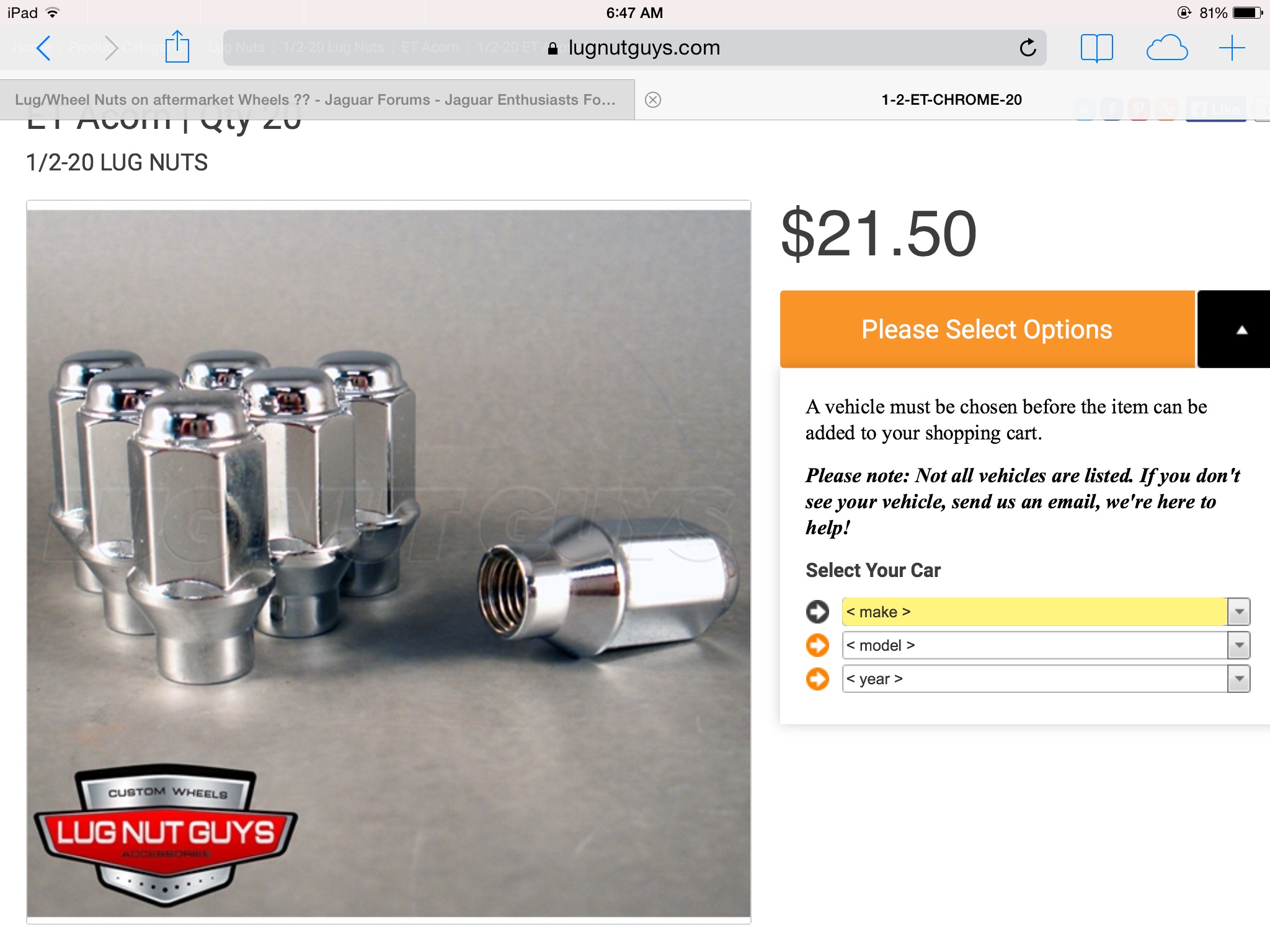

The new rims have a 60 degree bevel so will use beveled lug nuts. I found two sets I like, one is just the bevel and the other is the bevel with a shank similar to the stock flat nuts.
Which would you go with? Just wondering if the nut with the shank would replicate the stock nut the closest and be the safest. I do like the acorn bullet nuts better though. As the wheels are grey, see post #5, with silver highlights I wanted grey lug nuts to blend in but can only find black, chrome or stainless steel capped. The black would look odd as the wheels are a medium grey so I think the chrome would look the best.

Second set of lug nuts for above question. Using an iPad and there's no way to rename the photo's so only one per post will attach.
The extended thread shank will fit my new rims, actually a perfect fit for the lug hole size and the length is just short of the depth so the wheels will sit flat and the nut will torque down on the wheel only.
Thanks for your time...

The shanked lug nuts would indeed offer more protection for you. I think chrome would look best. Make sure they're solid - you don't want to be messing around with capped lug nuts ever again....

I'd go for the shanked ones as I'd be concerned that the studs would be too short otherwise.
