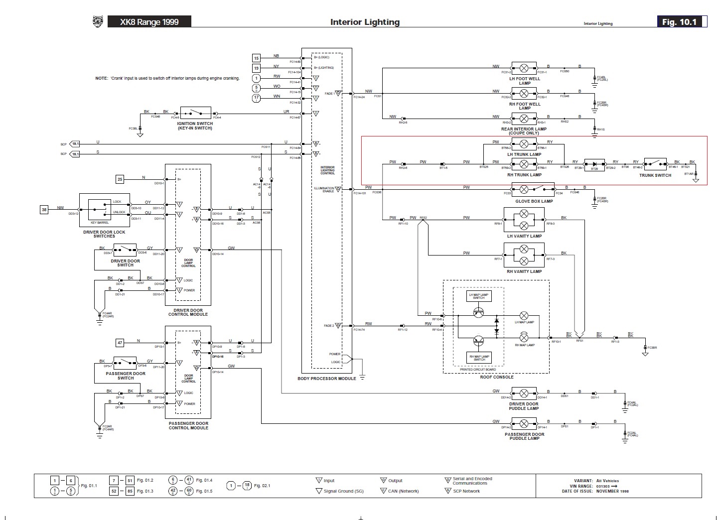

The Luggage Compartment lights on my 1999 XK8 Convertible are not working. I have tested the bulbs and they are fine, but I can't find the fuse for that line. Does anyone know which Fuse Box and fuse it is?

Controlled through the BPM (Body Processor Module) and not fused separately. see the section I've boxed in red:
As the bulbs are OK, suspect the switch or a harness break where it attached to the luggage compartment lid. With the flexing from repeated opening and closing, this is a regular place for a cable break.

I had the same problem on my '97 conv. and fixing the #7 fuse in drivers door fuse box solved the problem.
