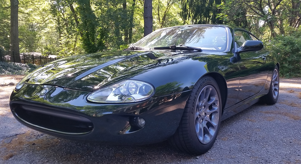

After several years of thinking and shopping for the right grille / scoop solution, I decided to go simple and old-school. Removed the plastic bits altogether, removed the bumper bar and had it sanded / painted / clear-coated to match the Dorchester Grey trim, and put it all back together. I'm very pleased with how it turned out.
