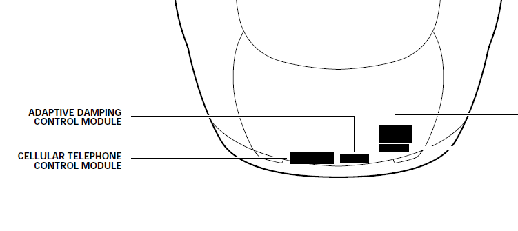

2000EG shows its location as in the trunk/boot:
..but it has moved around. Under the centre console in my car.
Odd that the radio is affected:- the two 5A fuses(one ignition (i) switched) are shown as dedicated feeds.
