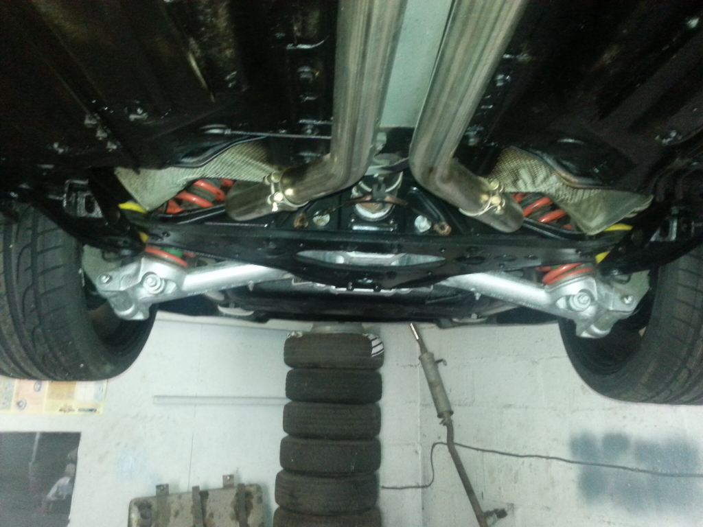

I bet that was a seaside car..... Very crispy..... I did one recently and it did not look that bad..
After

Nice stainless exhaust and paint job XKracer - but what is the first photo of? the rear sub-frame?

The top picture on my post is of the rear subframe, whilst the subframe was out I welded the main mount sections and chassis section in the wheel arch, waxoyled the lot before and after I refitted the frame
