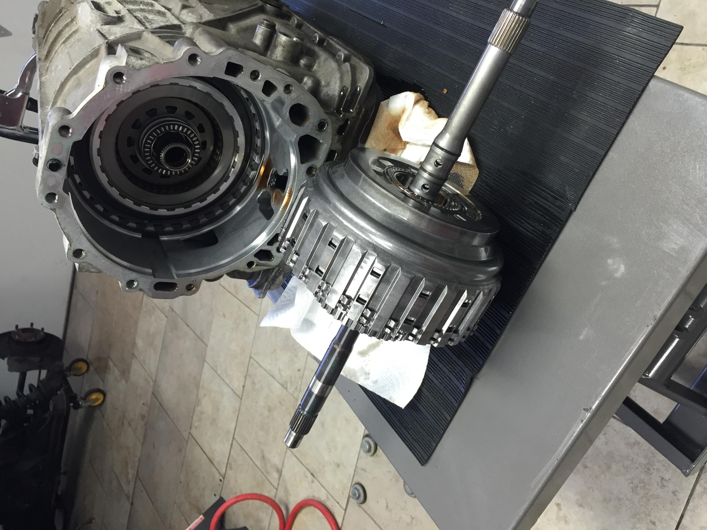

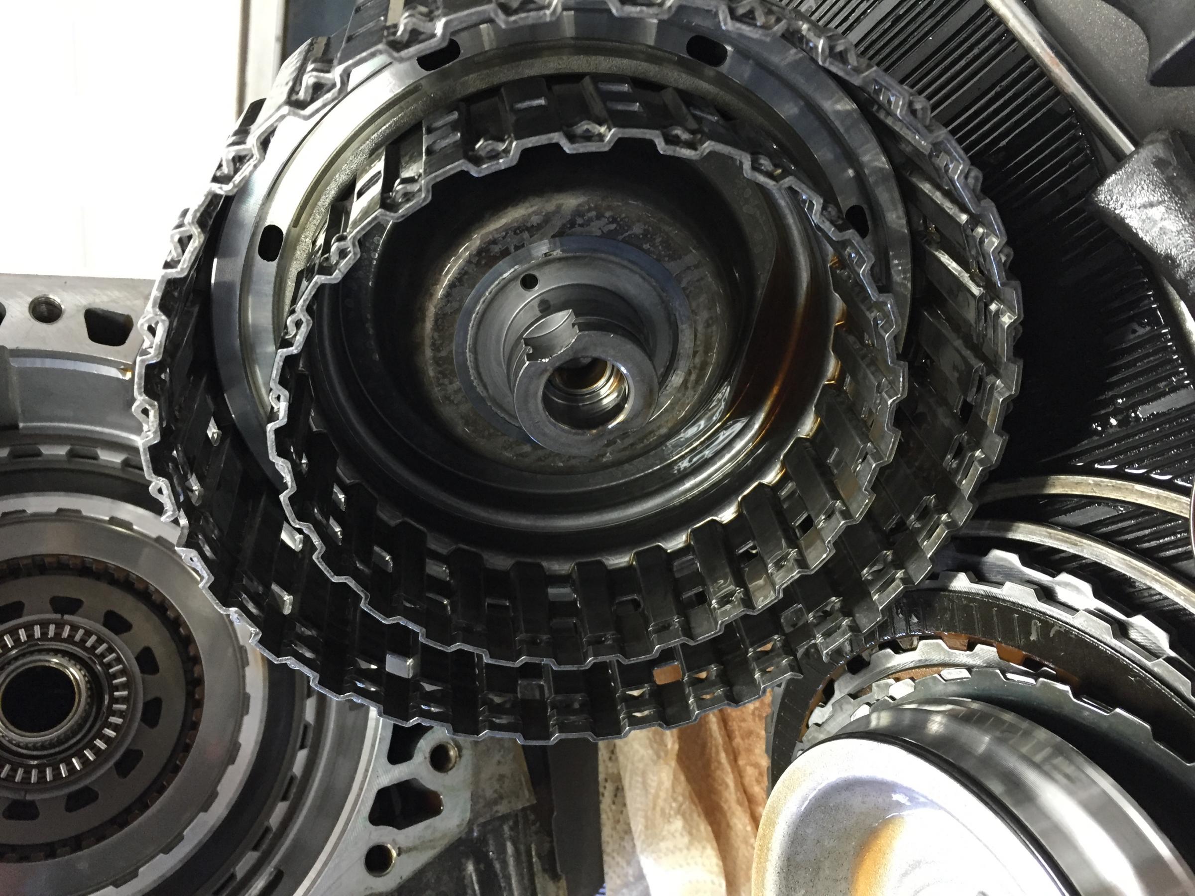

I replaced the A drum in the transmission. Not a hard job, but scary non the less. I haven't replace the pump seal and the torque converter o ring, and am now questioning if I should have.

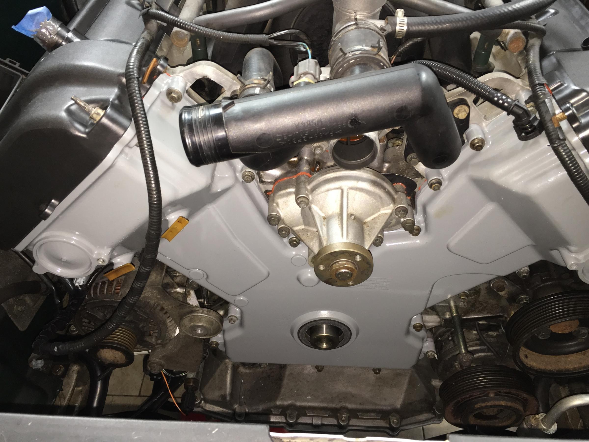

Here's an update. I may have bitten of more than I can chew. If this car actually runs after I get it back together, I'll be amazed
I cannot get the Harmonic balancer off. I plan on replacing the primary tensioner and guides as well as the chains. I have rented the removal tool. screw it in and the threaded hole striped. I rethreaded the hole, used a different bolt and it stripped again. I am at a loss what to do. Anyone with an idea?

2. Transmission removed. Rear main seal replaced. A drum replaced.
3. Engine, new timing chains and primary tensioners and guides. I had replaced the secondary tensionsers earlier. Also replace the upper and lower radiator hoses. Cleaned and painted the timing cover. New oil pan gasket. Cleaned and painted the oil pan. Valley hoses done earlier. New throttle body gasket plus cleaned. Repaired breather nipples using JB weld.

Well, it seems my work was about 66% good. The engine runs and sounds great. The rear end feels more solid and the differential seams to be not leaking.
The problem is the tranny. It is now slipping and chirping going into 4th. Under light load it's fine but just a little extra, and it slips. Looks like I will be removing the transmission again and bringing it to a shop to get looked at.
It's too bad because I took a tranny that was working fine and messed it up (trying to be precautionary and replacing the A drum, which looked fine when taken out). You live and you learn. Hopefully, it won't be too expensive to fix whatever I messed up.
