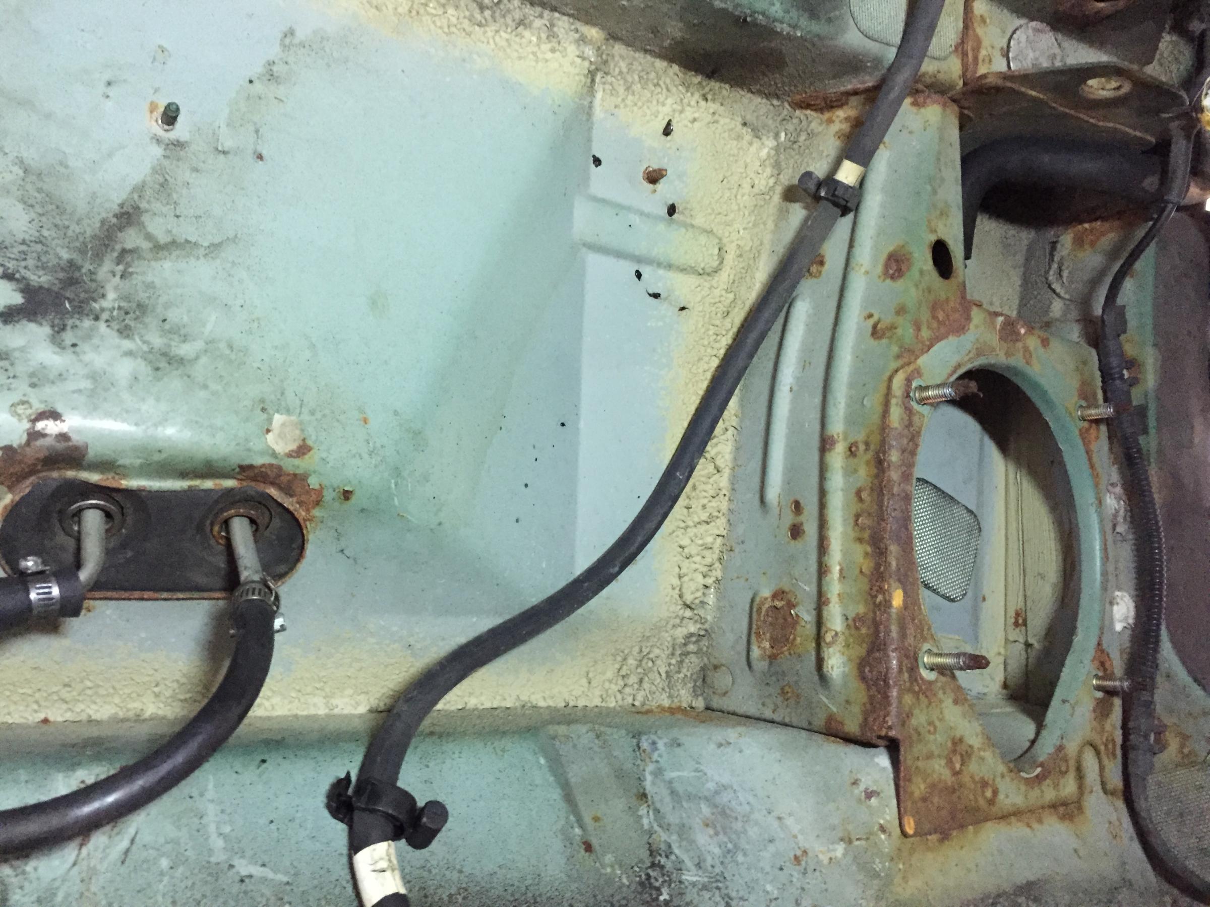

5. Rusted floor panels fixed

13. Small rust areas cleaned up with POR15

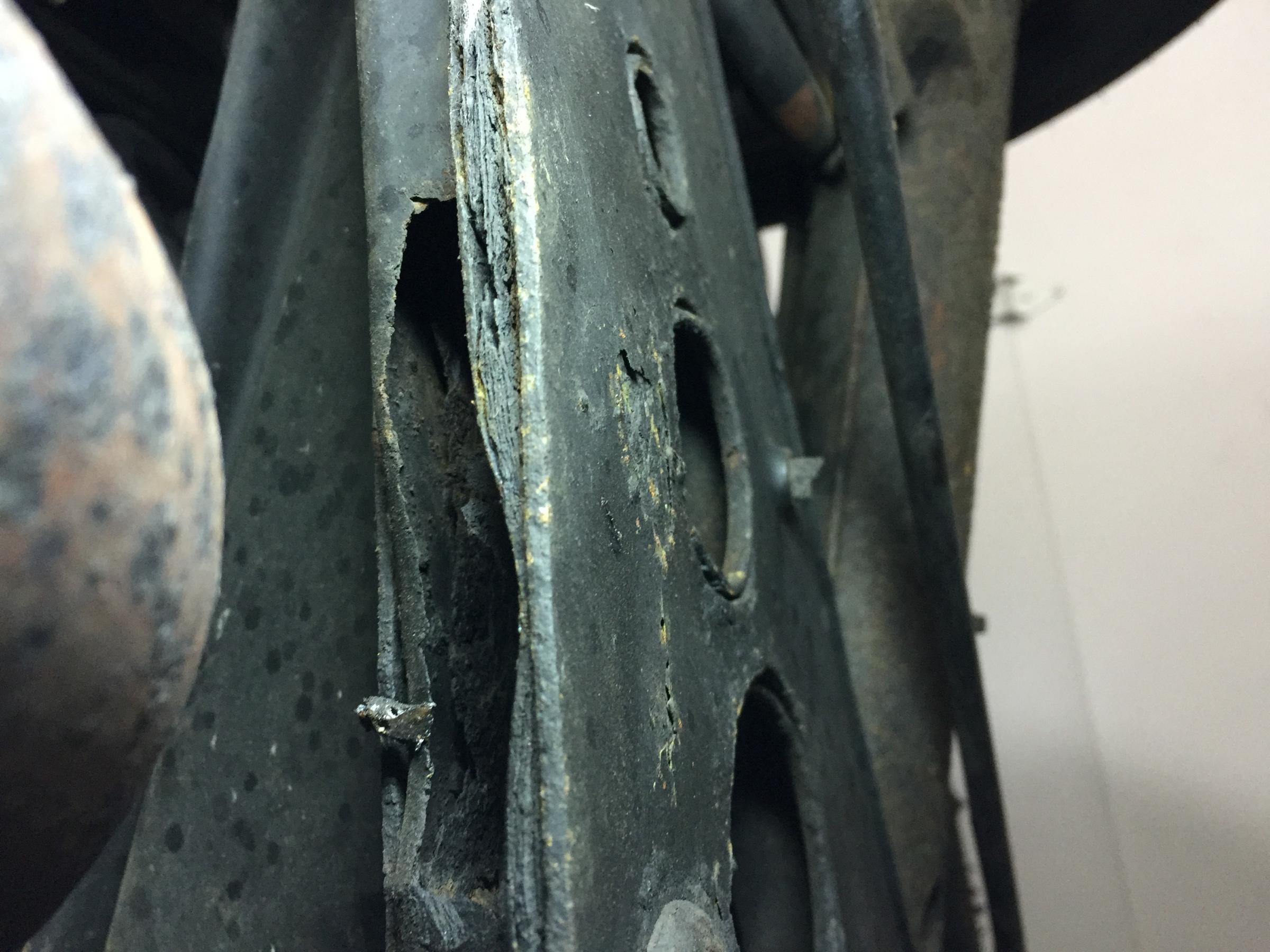

Next problem is the rear suspension. I feels fine and I don't really want to take the whole thing out, but there are rust wholes in the rear subframe. I feel a little weird about leaving it after doing all the other work. What do you guys think?

John, a well done for all the work so far. The leaks are a seal problem, sorry. The one on the pan could be more pain than the others. So many over tighten those bolts and it takes the flat surface out of the sealing.
I would look for a good used part on Ebay for that rear sub frame, a Florida junk yard would be ideal, no salty roads.

the rust on the rear sub-frame will only continue. With all the work you have done, you know the answer. Drop the frame, repair the rust and check out the all the other parts while you are there. If you do not do it, you will not be happy when you "must" do it.
That's a lot of work in a little over six months. Do you really want an engine oil and a transmission fluid leak to spoil the finished result?
1. clean off the engine oil and determine exactly where it's leaking before replacing the gasket.
2. transmission fluid from there looks horribly like an input shaft seal on the way out.
3. you 'll save a lot of time and get a better result in the end by removing the rear subframe to do the repairs rather than trying to work in situ.

Of course you're right. I love working on cars but for some reason I'm not looking forward to dropping the rear end. Oh well.

An update. I have the rear suspension unit out. Will be working on taking the tranny out this week. Rear main seal on order. Used rear main frame cross member on order. Wow.
