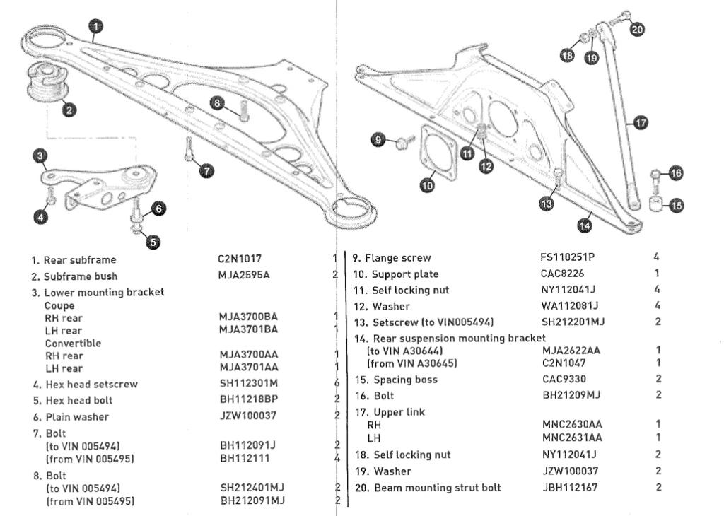

I hope to just blast mine on the car and coat with a protectant the guy mentioned above.
