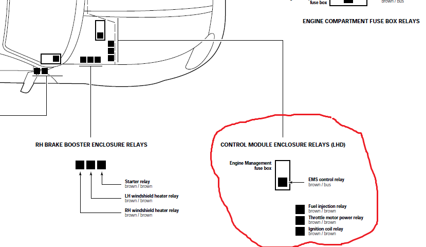

Hi.
You may want to check these four relays, both for proper seating, contact and internal conductivity. Use a small amount of electronic cleaner. Do not use WD40.

Thanks Oyster, I thought they were on the driver's side so cool.
I'll forward it to my Father, he's retired now so I'm sure he has time to check them.
Any idea on what values they should read with the continuity test?
