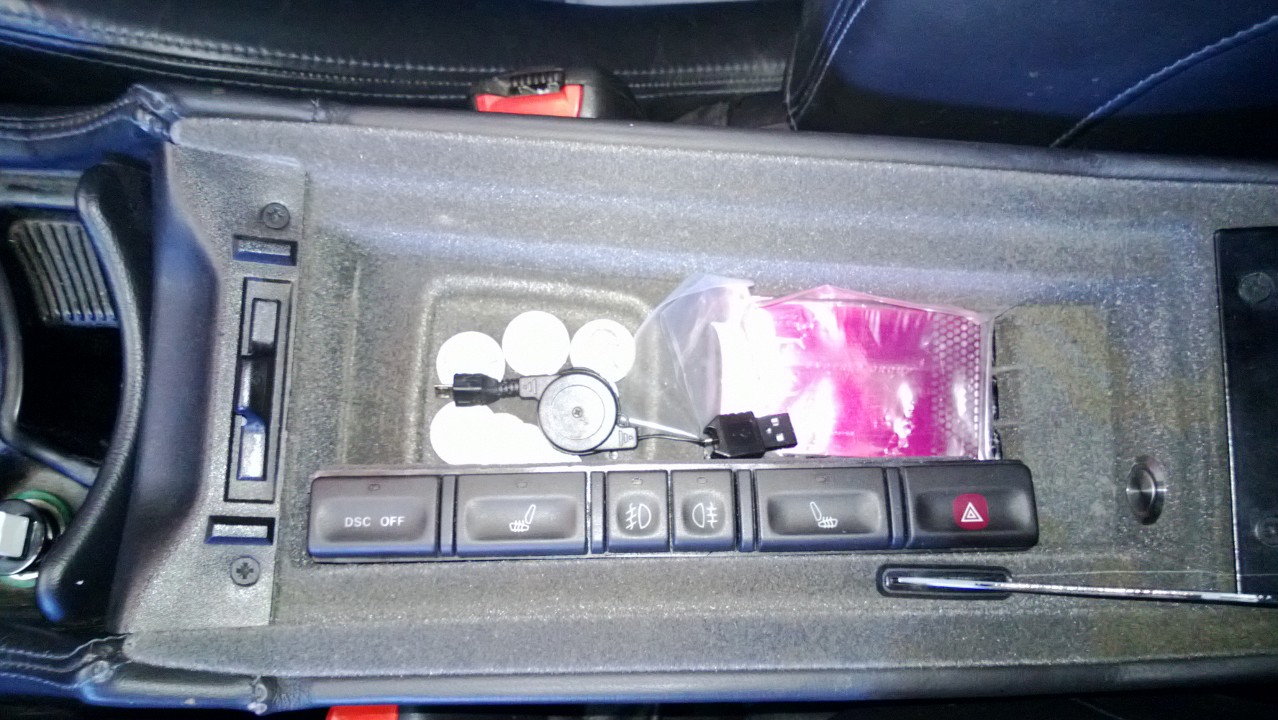

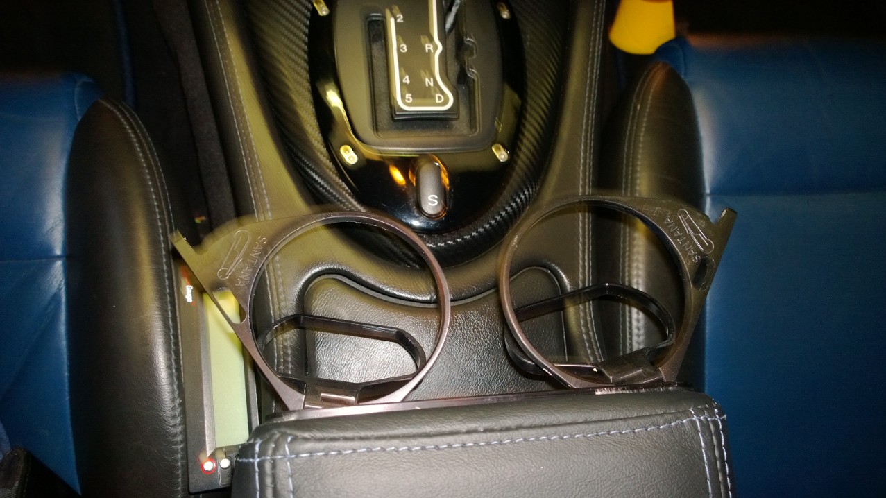

I did sound system upgrades on both the XK8 (1999) and XKR (2004). Did a flip screen single DIN in the XK8 and never did a panel and it looked fine really, though if I were to do it again I'd have moved the switches down and the unit up. Replaced the amps and speakers both times because the speakers suck (paper cone) and while I could use the XK8 amp it is really out of date. On the XKR the amp has a unique optical interface that nothing I could find works with (even another Alpine which I have as a head unit). Here are some pictures (by the way the sub in the trunk thing doesn't work).
Attached Thumbnails Need Advice - Planning radio upgrade and stuck-dsc00636.jpg   Need Advice - Planning radio upgrade and stuck-dsc00637.jpg   Need Advice - Planning radio upgrade and stuck-dsc00639.jpg   Need Advice - Planning radio upgrade and stuck-dsc00638.jpg   Need Advice - Planning radio upgrade and stuck-wp_20130318_009.jpg

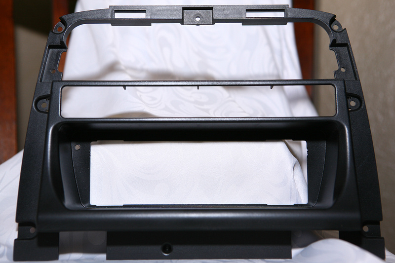

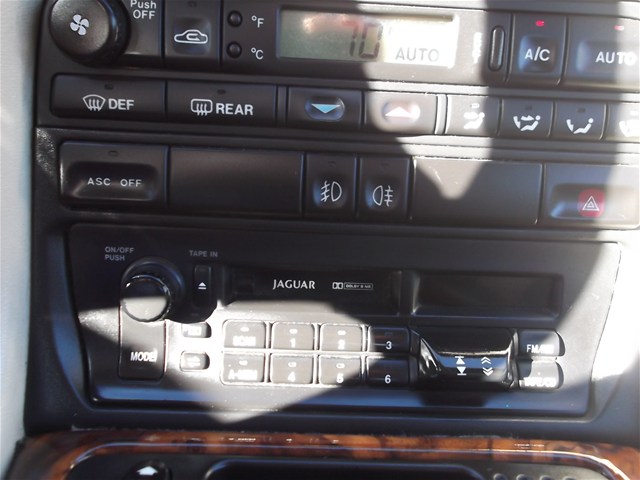

Ok... the early 97's had a different radio than the later xk8/r's... the bezel was also different and that is the one you need. The external dimensions of the bezel are the same and the a/c controls and the heated seat buttons are all the same... it is just the opening where the stereo fits that is different. From another thread, here is a pic of the newer style we have and the older style below (the part # LJA6318AB) which we need (and this pic has that nexxia adapter installed in the opening as well):
Without the Nexxia adapter, the one we need looks like this:
And here is the old style WITH the radio that we need to find since it appears we are going to have to get USED items:
Hope that helps clarify things

Below is a picture of part LJA6318AB in a 95 XJ6. Compare to Blindside's above from a 97 XK. Although the radios are different, the bezel is the same.
You will still need the Nexxia adapter along with this part. And thanks to Blindside for digging up the pictures of the fascia adapter. Hopefully this makes it a little clearer!
