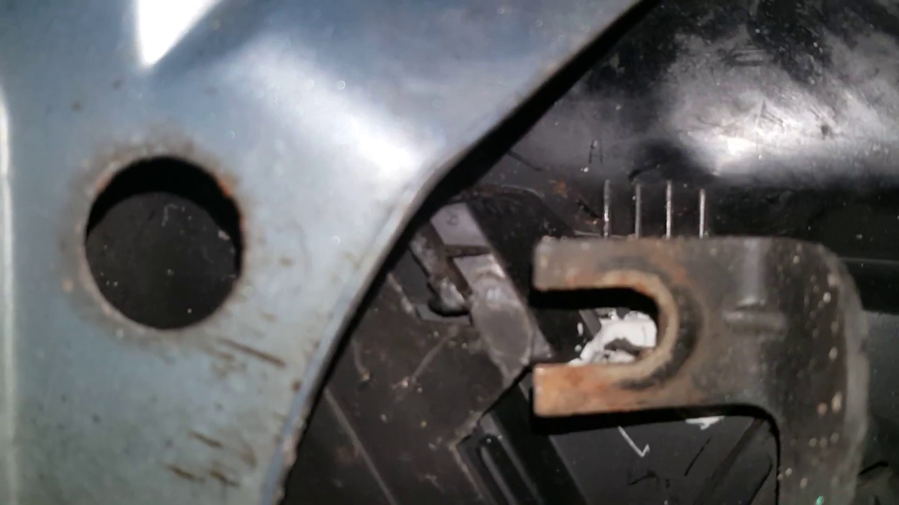

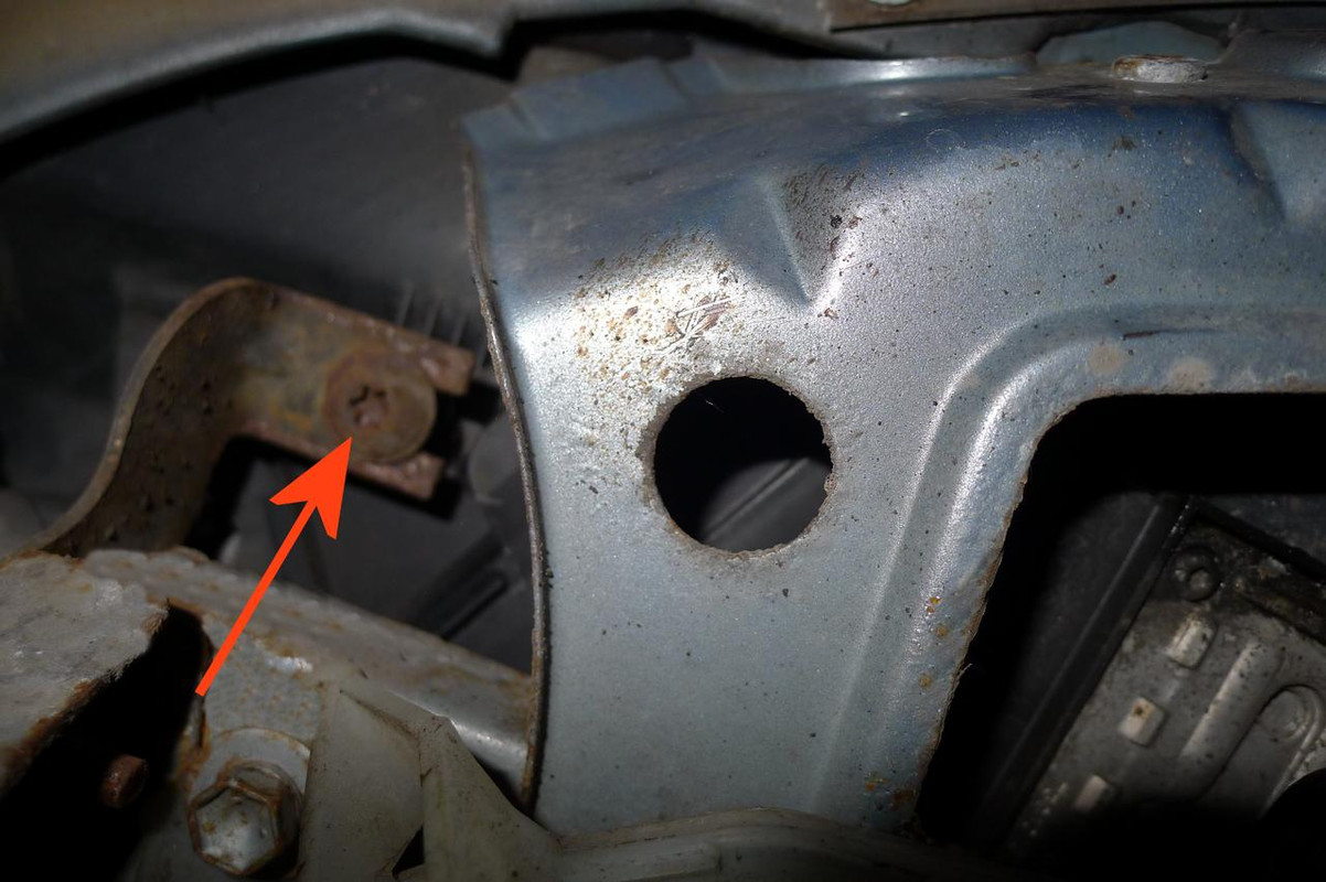

Tip for you. When you have removed the headlamp to swap the front bit over first heat the clips with a hairdryer etc. If you do not soften them first they will snap.
You will also find the screw underneath the headlamp a real bar steward to remove. Id advise cutting the head off it and not replacing it.

The one that should be here.
This was on the other side of my car. Not removed, obviously.
