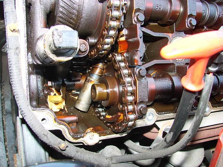

This might have been the next view that you would have seen if you would have waited a little longer:
Attached Thumbnails NEED HELP PLEASE - Doing tensioners now, camshaft won't budge-jagtimechain12.jpg

Oh, that's a horrible scenario. And you're right...I was close.
You know, I bought this car back in early June from a Land Rover dealer...a local doctor had traded it in after 10 years of ownership. I managed to get in touch with the doctor before I made the purchase, and he mentioned (without me asking him) that the tensioners had been changed to the second generation several years ago, possibly before his ownership.
Well, based on what I've seen today, the originals were replaced with another set of first generation tensioners, or they were never replaced at all. But could the original tensioners have gone 111,000 miles without grenading the engine?
I just changed out one today, I'll do the other in the morning. Then I'll take a few snaps and post some pics. Bad stuff. Now I'm wondering about that piece of missing tensioner shoe...perhaps I should drop the pan and look for it? Could be long gone by now, but one never knows.
It's not only the broken tensioner which is worrying.
the sludge which is built up is even more worrying, it looks like the oil has never been changed in this engine.
Even the cams on the camshafts are dark brown!
I think the general advice if that it's got down into the pan it's not going to do any more harm from there.
You're right but I don't suppose it matters now.
Agreed, This engine has obviously had very infrequent oil changes probably combined with short trips. No excuses for this poor level of maintenance on any car much less a Jaguar!
Fortunately, this is not my car, I just copied this picture from a article or previous post.

Heard that sound of chain on metal. limped home and that picture is exactly what I saw when I pulled off the left bank cam cover Tuesday. Hope to have it all back together tomorrow. New belt as well as PM.
