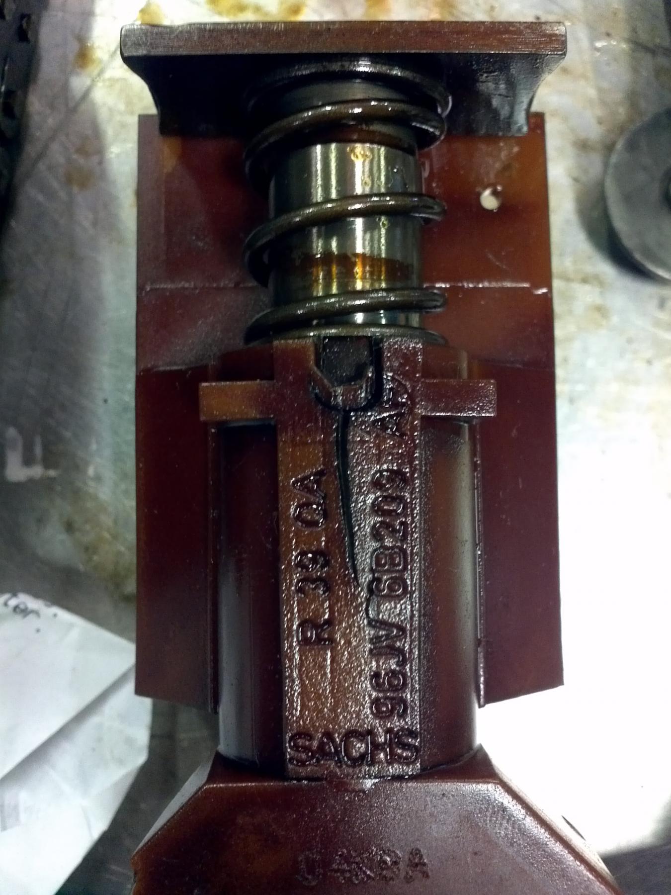

Ok so the timing chain broke while the car was idling. That definitely contributed to not bending any valves. The car has 60,000 miles and not a spec of rust. We replaced the whole timing chain setup with the new metal tensioners and guide rails. Now all the covers have to be put back on. Thanks for all your help. I didn't take many pics but will post up a few.

pics
Attached Thumbnails Need information on setting timing.-2015-01-10_12-00-48_418.jpg   Need information on setting timing.-2015-01-10_12-00-56_213.jpg   Need information on setting timing.-2015-01-10_12-30-57_402.jpg   Need information on setting timing.-2015-01-10_12-31-03_618.jpg   Need information on setting timing.-2015-01-10_12-31-46_55.jpg

Congrats! Nice clean engine, glad it survived.
That was easy wasn't it. $2500+ at the dealer.
Be sure to send off for your 'I changed my own tensioners' medallion.

It was very easy. Once everything was locked down it was a snap especially because we had 2 cam locking tools, one for each side. the worst part is removing and replacing the hood and radiator and all that stuff. My friend bought a kit that comes with all of the tools needed ( both cam locks, 2 types of crankshaft locks, wedge tool for tensioning the chain, exhaust cam wrench thing, and the vvt wrench thing. We do not need it anymore so he is probably going to sell it on ebay. Maybe someone on here would like to buy them? What is the " i changed my own tensioner" medallion"? This is NOT the kit he is selling but the kit he has is the same kit. http://www.ebay.com/itm/like/1515409...lpid=82&chn=ps. What would be a good price for the kit?
