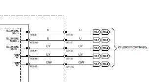

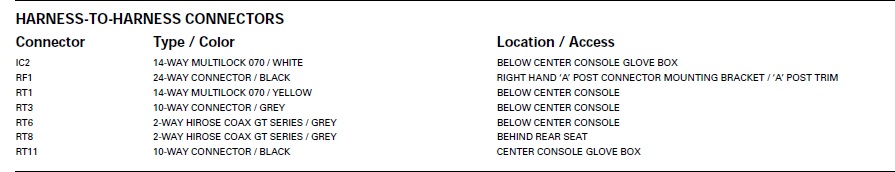

Testpoint, just to clarify, the PDF you attached is for a Jag XJ. The instructions are similar, but the connector pin numbers and wire colors are different on the XK8. The corresponding 2001 XK8 schematics are below. Also any references to the ACP network do not apply.
Also the Parrot CK3000, CK3100, and CK3200 are other choices.
Note the above are for phone only.
If you want to integrate an MP3 player with the phone, as some of the newer devices like the Motorola T605 do, yes, you need to tap into the AI-AUX connections for full stereo as Testpoint's link shows. If you go this route, in my opinion, a better way is to use the PIE AI-AUX (http://www.myradiostore.com/auxadapt...lp-ai-aux.html ) and avoid using relays.
