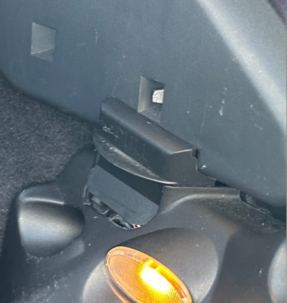

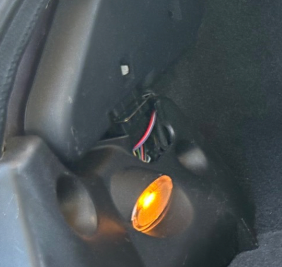

I noticed that I am missing a cover piece that goes in the taillight area of the trunk/boot interior.
Picture #1 shows part is missing and the exposed wiring.
Picture #2 shows cover marked PULL in place.
The attached pictures show the area with the cover missing (pic 1) and another with the cover in place (pic 2).
The part in question is between the cover for the taillight and the bottom cover that holds the trunk lights. There is one on both the left and right side marked "PULL". Not sure if both sides are interchangeable or if they are unique to each side. If anyone has this on their car would you mind pulling them off and posting the part number(s) please. Obviously not critical to have, but it bothers my OCD nature to see it missing every time I open the trunk.
Most likely the part is now in the unobtanium category, but I might get lucky with a used one.

They are handed.
On my car, looking forward:
LHS: HJA5293AB
RHS: HJA5292AB
'Jaguar Flap'
Neither of those exact numbers show on Heritage, but HJA5292AC available, HJA5293AC unavailable. Presumably the same parts.
