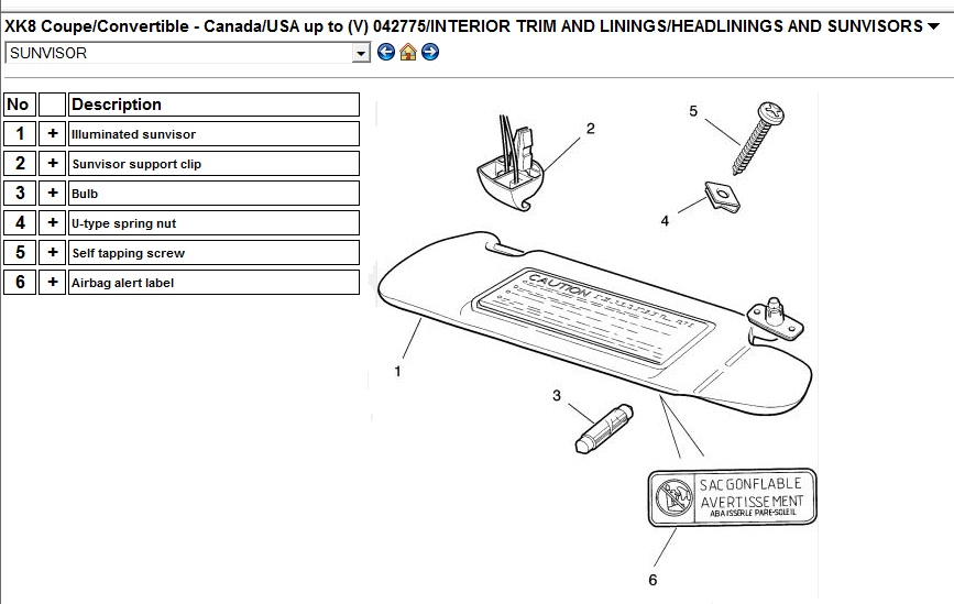

Had car detailed last Friday and they managed to pull the screws out on the drivers side bracket and they will not go back in, so does anybody know of a way to fix this little mishap?
The bracket is fine, screws will not bite into anything in the header.

randyb,
Try slightly larger self tapping screws unless the screws that came out were threaded in which case you may need some new inserts.

From: Quad Cities IL
There should be a square hole with a plastic insert. take a flash light look up inside. If the inserts gone you'll need to replace it. Be careful the wire to the mirror is up there and some people including myself has pinched it and blown a fuse. This fuse also is tied in with a sensor or switch on the J gate and will not let you shift the transmission.

The Bracket with the two holes on the visor itself or the Sunvisor Support Clip (item 2)?
The screws for the Bracket with the two holes are secured in Spring Nuts (item 4).
The Support Clip is a push fit into a plastic clip.
Whichever it is, the appropriate clip could be just dislodged or may be broken. Easiest way has to be to replace the securing clip.
