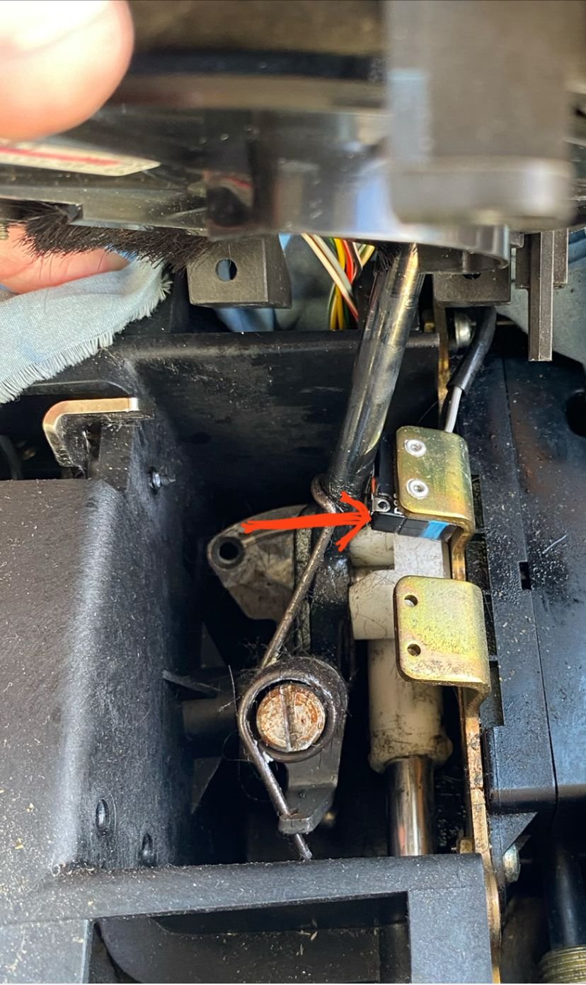

Hi, trying to solve my problem, need help. 1998 XKR. Starts normally but sometimes would not crank, when I jerk the gearlever it starts, sometimes need to press it a bit hard forward an to the right to start. Sometimes starts in N position, not always. Have a red arrow at what I think is the Neutral safety switch, is it?
Tryed to adjust the gear-cable, up with the gearlever,, not sure I did it right, made the wire going about 2 mm forward.
Living to far away from a Jaguar service, tried to get help by phone, no success.
When I move the gearlever, every light indicator lights up properly. Pulling it from P to the left, a signal sounds, indicate the neutral safety switch works?
Tok away all the trims, greased with spray, become better for some time, then back to the problem again. Looking at the wiring at jagrepair, it looks like the switch grounding the cable, would it be possible to jump-connect it to be safe? Is it more than one switch? Where are they located?

Check the colours closely. It looks as if the switch in the photo has a wire with black in it and one with white. I think the wiring diagram shows Black/Pink and Red/Blue but you need to check the colour key. I think the Neutral Switch might be build into the selector module on the gearbox.
It does sound like something is slightly out of adjustment on the gearchange mechanism.
Have you checked for fault codes?

Thanks for answering There is no fault codes, have called all thinkable Jaguar service places nearby, no success yet. Nearest answer was that the switch was located underneath the J-gate selector, also checked inside of that, and there was just a small cirutboard for lamps, no switch. You are absolutely right about the colors, who indicates that the switch in the enclosed pic is something else. May be an adjustment need, does not know how much or direction, any clue?

Thanks for the video, had solve my problem, if I have had the same gear-equipment. Mine is without the switch in the J-gate and just one at the gear leve. And the one I got, seems to be working, and wrong color. 🤔

Make sure you are looking at the wiring diagram for the supercharged version (SC) rather than NA. It shows the park/neutral switch is on the linear selector, wire colours RU and G. Remember those are the harness colours, not necessarily the colour of the wires at the switch.
ETA: The wiring diagram also shows a NOT IN PARK MICROSWITCH - this looks like a separate switch presumably on the gearbox itself. Maybe someone else can confirm if the Mercedes box has this as well as the ZF but I assume so.
