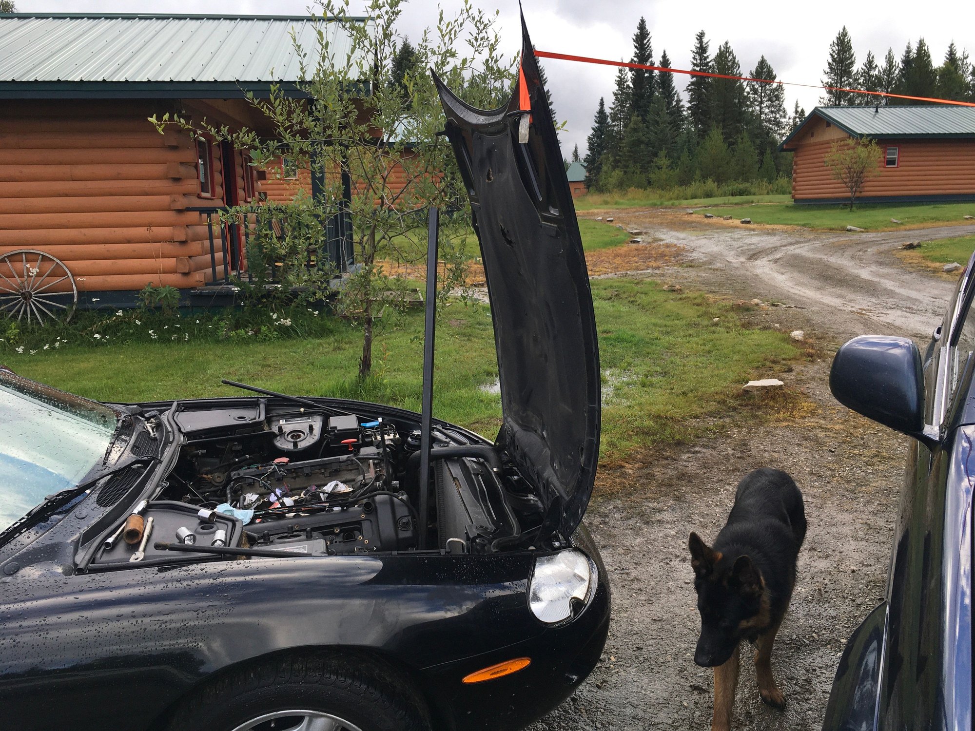

First service position.
Tools: 1. a thin small flat blade screwdriver
2.An old cushion or similar (read on it'll make sense)
3. 4 inch bolt, or something metal with the right Outside Diameter (read on)
Open hood. Place cushin on top of manifold. Pick a side, go to strut holding hood open.
Look at the strut/ hood connection. See the U shaped collar on outside of strut?
Stick screwdriver under it. Slide it back a bit to release position (cup it with hand to prevent flying away)
Hold hood weight, slide strut off hood pin.
Now you only have 1 strut holding hood up (not strong enough), plus the strut you just released can't be made flush that's why the cushion box or whatever is there. Lower hood onto it.
Put that bolt in your pocket for ez access.
Release strut other side.
Look at hinge. See the hole? See how they line up of hood vertical? Slide the bolt in. It'll support the hood, which is now in vertical position.
D, the closer you can get size wise to filling up that hole the better it works. Now that you understand, pick a good sized bolt. Not too long or its end may tilt down and scratch something.
DO NOT do this in moderate wind. You will loose ( don't ask. . .)
John

You will also need some serious mechanical advantage for the crank bolt. (no, not the dog hes ''health and safety'').
It will prove to be one of the best tools in your toolbox:- together with your sense of humour you're good to go
Thanks for the info and the picture. I've got a 5 ft long 1 1/2 id water pipe that I use for "gentle persuasion". Your image well describes the mechanical advantage needed for a crank bolt. The dog would always be welcome, and could understand the struggle. Green eye's cats simply yawn and go back to sleep.
