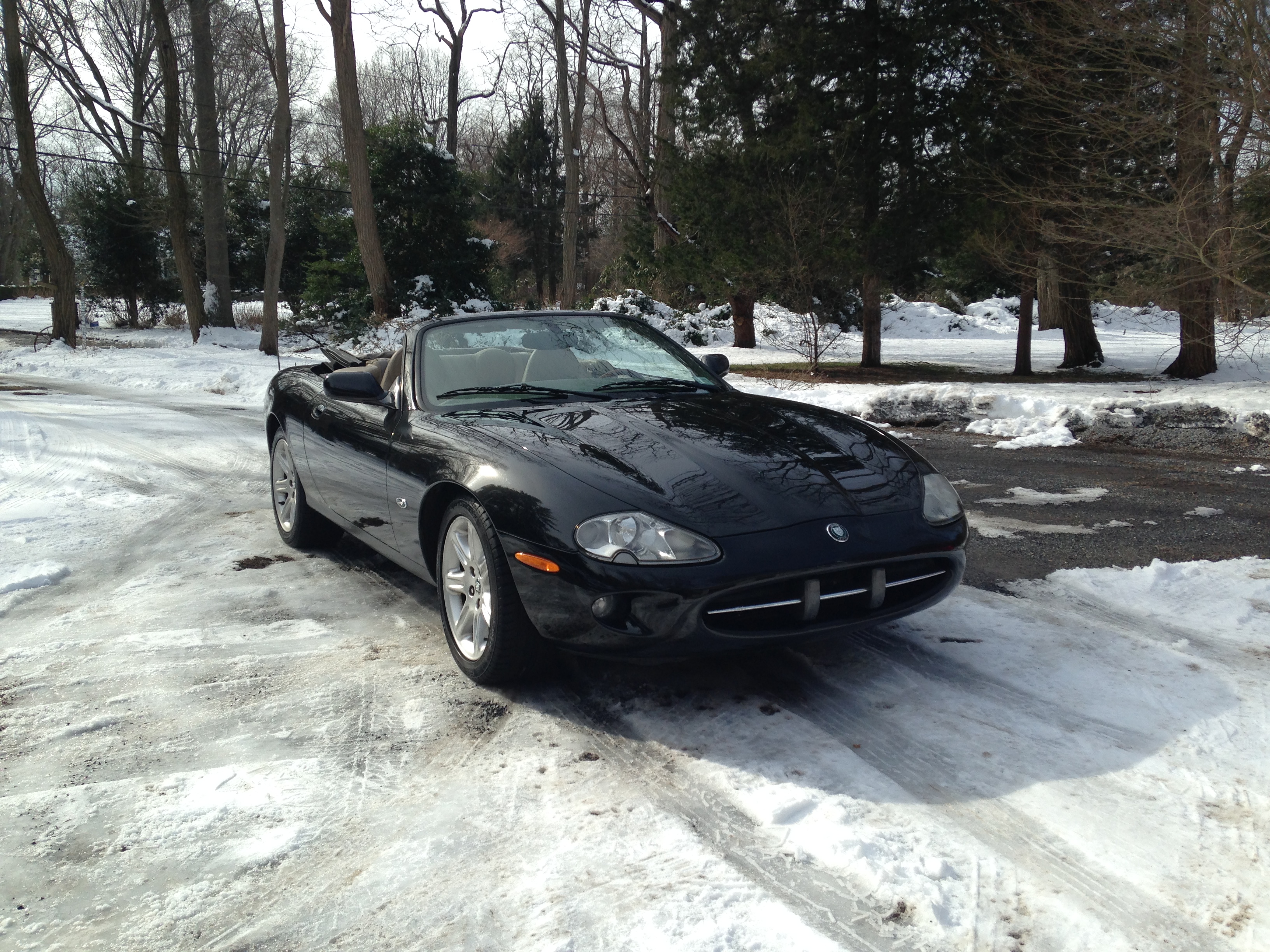

Gents:
I'm finding a few issues with my new XK8. Let me know if you have any insight on these:
  1. Trip computer won't clear, switch A/B, or reset
  2. Cruise control doesn't work
  3. Power antenna won't go down (it goes up)
  4. Seat/wheel auto positioner doesn't retract (it does go into the preset upon entry)
  5. Engine failsafe mode comes on, but clears after restart, and it runs fine while it's on
Appreciatethe help and feedback.
Thanks,
Tom
