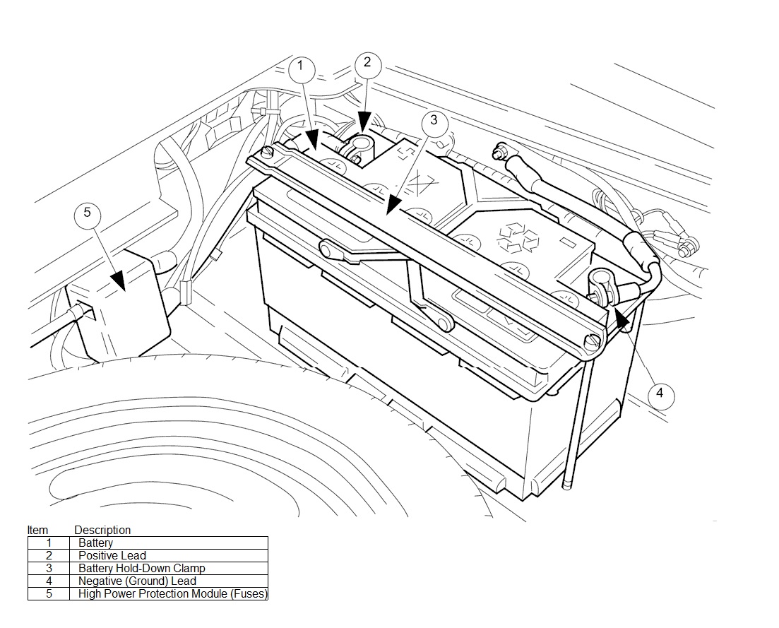

As everything else appears to be working apart from the starter, check the cables and fuses in the High Power Protection Module (item 5).
The High Power Protection Module has three 250A capacity fuses. Two fuses are connected in parallel to provide protection for the starter circuit and the third one provides protection for fusebox supply circuits.
A loose cable has previously been reported as the cause of the issue you describe.
