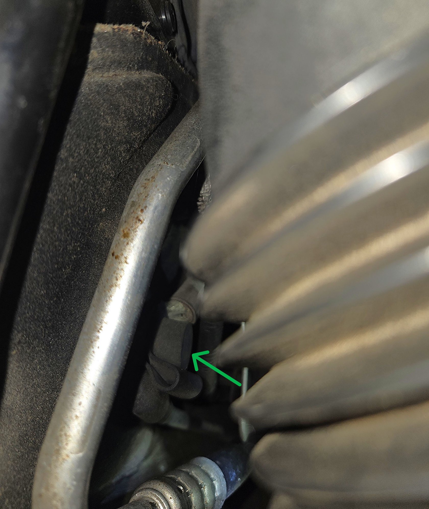

Old Nov 17, 2025 | 07:59 PM
cjd777's Avatar
Posts: 2,954
Likes: 1,597
From: Spencer, NC
Good news Joe.

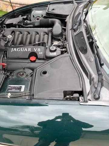

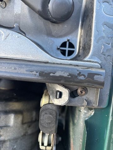

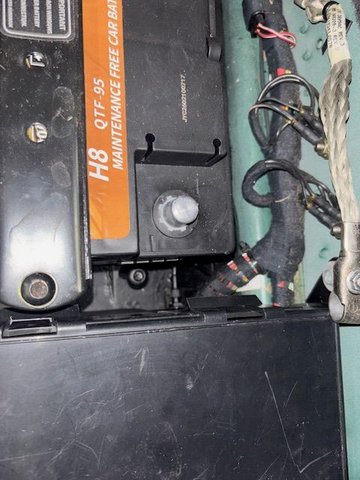

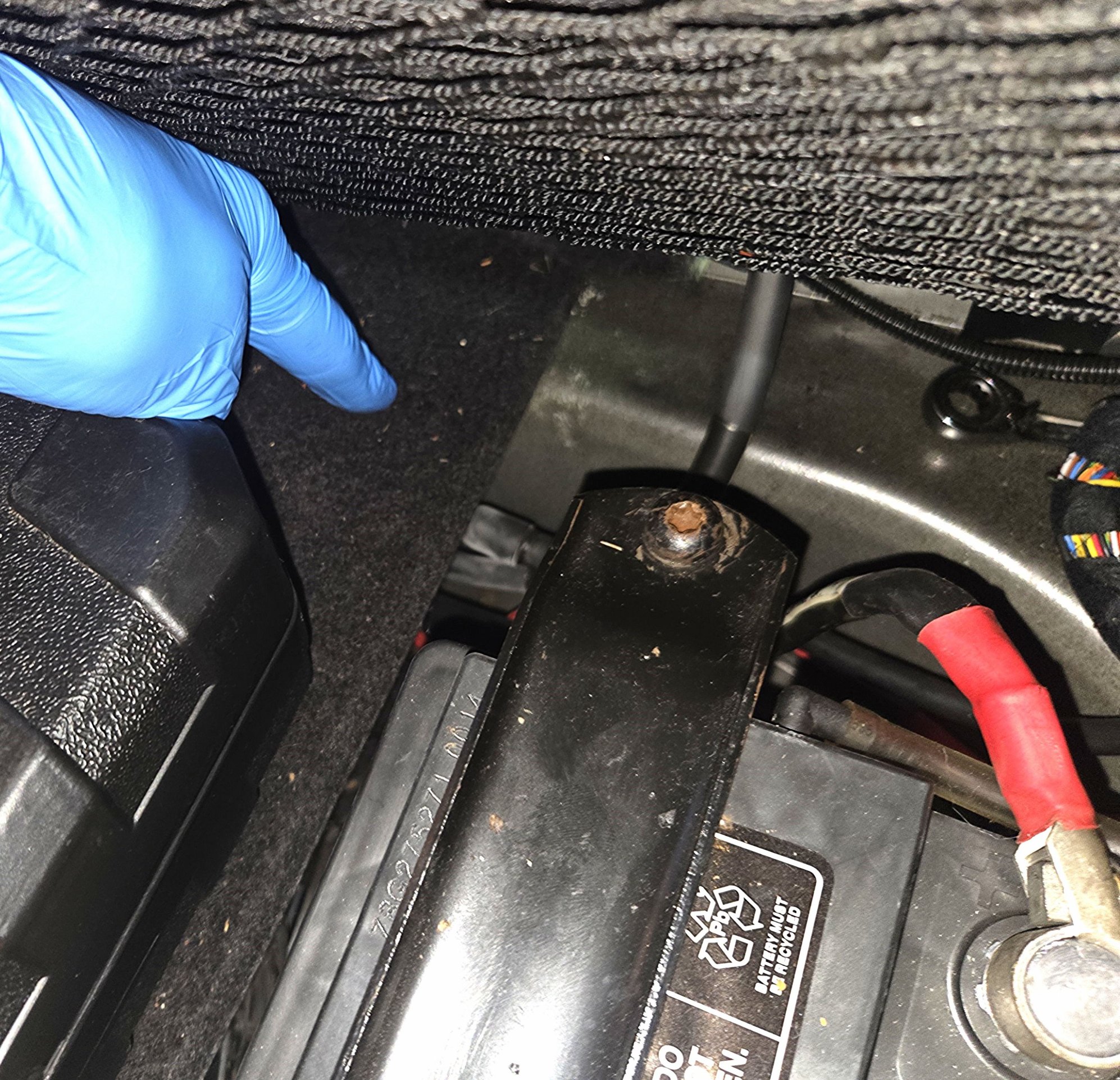

Did you see the little funnel and the hook it's attached too?
I can see it in the picture but it's not something that will jump out at you. The little square part in the corner of the one with the brake on the left downside. Pull up the plastic that is hooked on the tab and make sure the funnel is clear of junk, if so, run a wire down in the tube that goes out of the car.
There is one on each side, so glad you didn't have a puddle waiting on you.

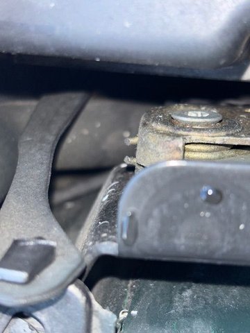

Old Nov 18, 2025 | 10:18 AM
OCJoeR's Avatar
Joined: Oct 2024
Posts: 455
Likes: 82
From: Orange County Califorina
Wayne,
I'm guessing you're talking about these tabs that appear to be connected to the little tubes that seem to run from those holes at the bottom of the cowling into the 2 compartments in the engine compartments.
Port Side 1 Port Side 2
Starboard Side 2 Starboard Side 1
Starboard Side 1 Starboard Side 2
I'll have to find a solid wire to fish down the hole in the cowling to see if there are any clogs. I put a light down into the compartments and don't see any signs of water being trapped in there but who knows at this point. What I am wondering was who the electrical genius was at Jaguar at the time this was done. Of all the places that they could have put the drain for that water why would anyone with the least bit of knowledge of electricity put them in the one place where they would come in contact with not only electrical wiring, but the 2 most important computer modules in the whole car, the ECM and the TCM!!!! I mean this had to be a joke on all Jaguar buyers. "Let's let the water drain into the car's most important electrical component so that we can sell more service calls and cars". What complete idiots. (or crafty *******s).
Joe

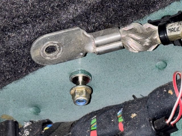

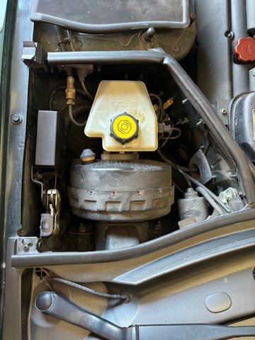

Old Nov 19, 2025 | 04:23 PM
OCJoeR's Avatar
Joined: Oct 2024
Posts: 455
Likes: 82
Don,

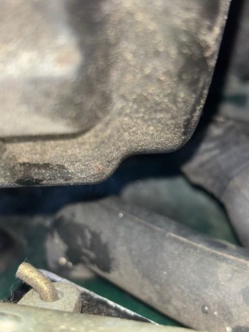

1. Remove and clean both ends of the engine ground strap. It is subject to contamination from oil and corrosion. Clean away any oily sludge and inspect for corrosion that may have migrated under the eylet terminal crimps. Clean the eyelet terminals with a small brass-bristle brush (never sandpaper - the scratches promote future corrosion) and zero-residule electronic contact cleaner (CRC makes a good one available at most auto parts stores in the U.S.). Also clean the points on the body and engine/bell housing where the cable connects.
Having been under the car before I recall that the bolt on the transmission that holds the ground strap is very close to the Catalytic converter. I don't think I can get to it. However, I've seen several videos where owners have attached new ground straps using other bolts. I think I'll give that a try. I can buy a bunch of ground straps for $15. Just a matter of finding another bolt on the engine and frame and cleaning the area around them.
2. With the battery disconnected, disassemble, clean and re-secure the false bulkhead connector on the forward edge of the plastic Engine Management housing at the right side of the firewall in the engine bay.
Is this the false bulkhead connector?
This is the compartment on the right side of the engine compartment. Is the cable with the yellow cover the false bulkhead connector?
If not where else should I be looking?

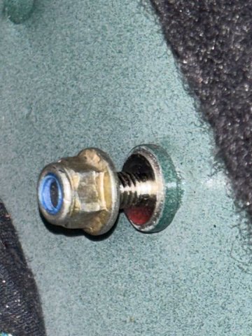

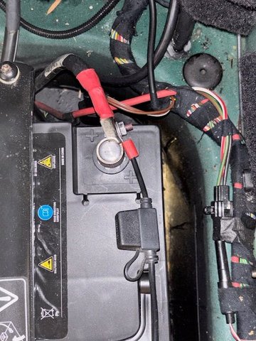

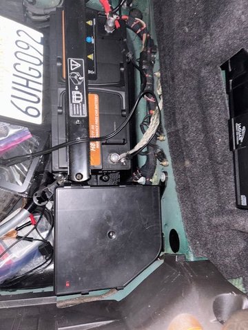

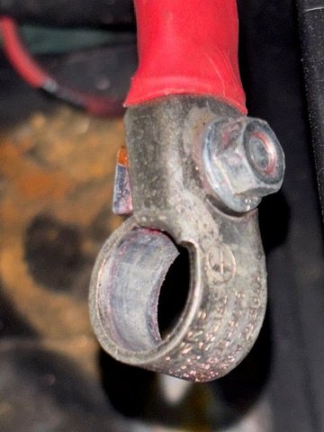

3. Remove the battery, detach and clean the battery ground cable connection to the body. Then remove the plastic cover from the High Power Protection Module (HPPM), take photos of how the fuses and cables are connected, then disassemble, clean all the fuse blades, threaded studs, eyelet terminals, washers and nuts, flush with electronic cleaner, allow to dry, then reassemble, taking great care to return all wires to their original positions. The nuts on the threaded studs don't need to be overly tight - just good and snug.

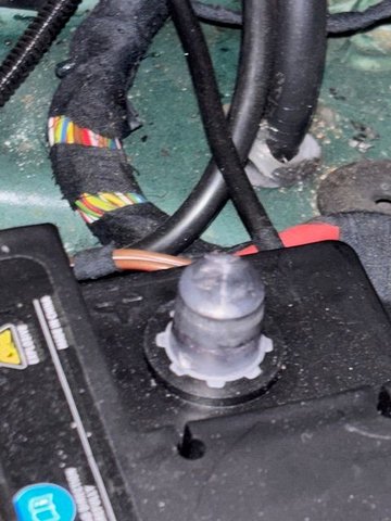

Here's the battery. The ground cable connections to the battery and the vehicle look very clean. I cleaned them when I put the new battery in a few months ago.
Overall Battery Positive Terminal
Ground Cable to Body Ground Terminal

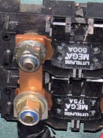

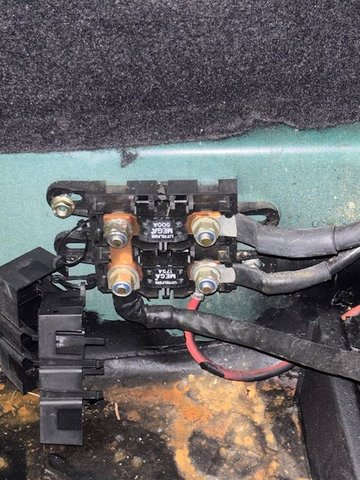

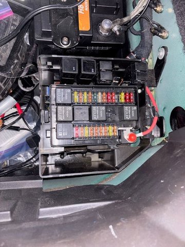

Is the HPPM the box just next to it? Are you saying I need to take that whole box apart and clean all the connections, wires, fuses and terminals?
HPPM ?
HPPM ?
Joe
Old Nov 19, 2025 | 08:09 PM
Don B's Avatar
Posts: 20,558
Likes: 15,318
From: Crossroads of America

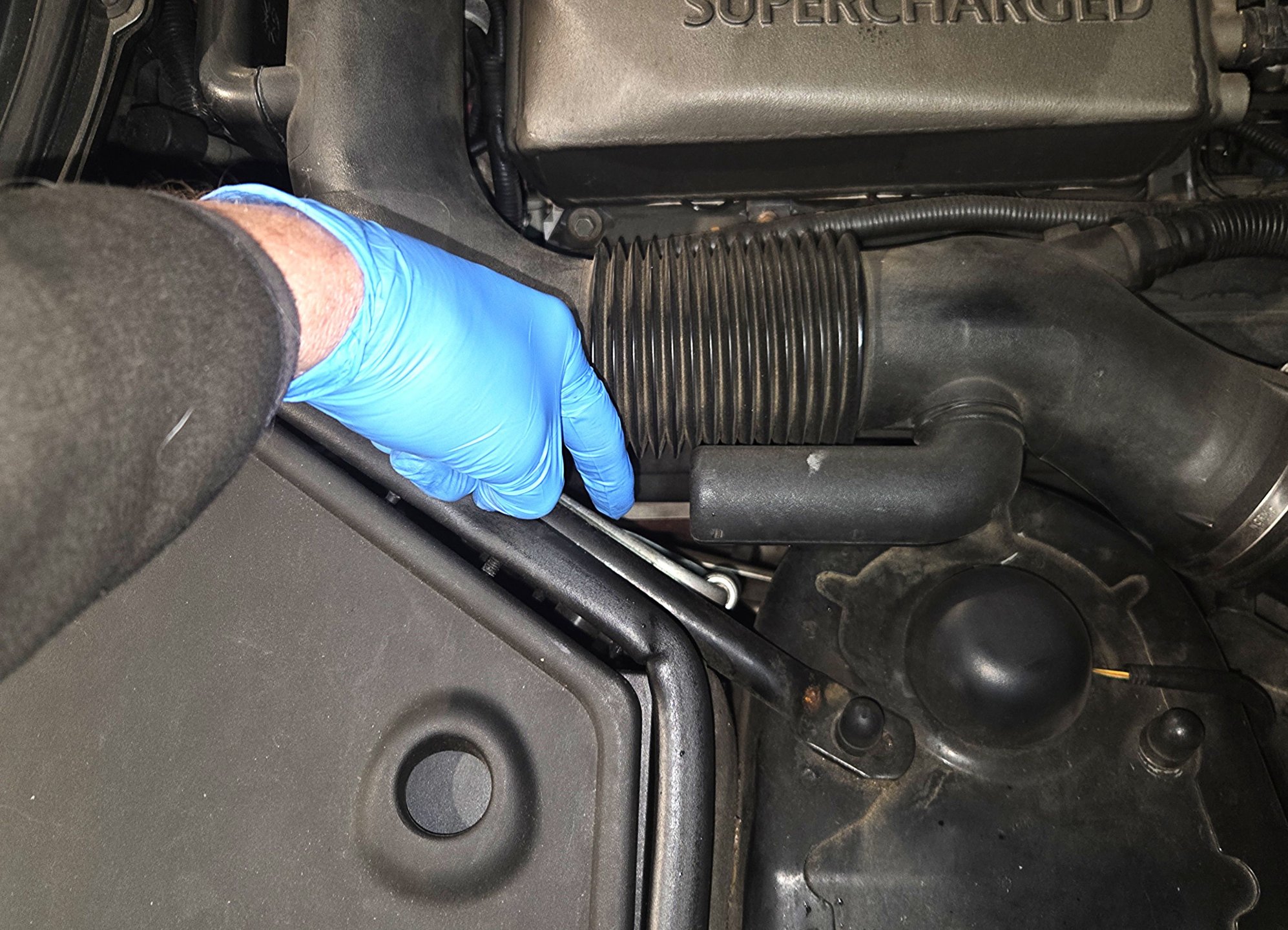

Hi Joe,
The High Power Protection Module is forward and a little left of the battery, behind the spare tire. Here's a photo of me pointing to its location. If my trunk wasn't full of tools and cleaning supplies right now, I would have removed the floor panel to take a better photo. For a better view, see pdf page 11 of the attached document by our member avt007 (Rob). It was written for the X308 but most of it is directly applicable to the X100.
Regarding the False Bulkhead Connector, sorry if my description was confusing. in my mind's eye I was seeing the X308 connector. On your X100, the connector is down on the inner side of the Engine Management enclosure at the right end of the firewall. Here I'm pointing to it:
Here's a poor photo showing that the connector is down below the A/C refrigerant pipe. I've added an arrow since the black rubber cap is difficult to see. For access, remove your plastic air intake pipe.
Regarding the battery negative cable body connection, it looks great, but the important contact surfaces are hidden. You cannot tell its true condition without disassembling it, and while you have it apart, clean the eyelet terminal, threaded stud, washer(s) and nut and reassemble. Likewise, the battery cable terminals and posts can look clean but have corrosion on the contact surfaces.

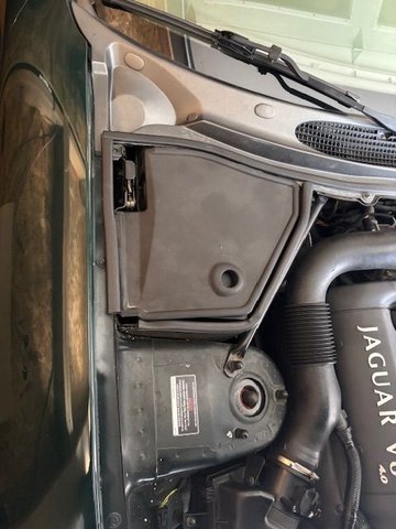

Old Nov 20, 2025 | 08:59 AM
OCJoeR's Avatar
Joined: Oct 2024
Posts: 455
Likes: 82

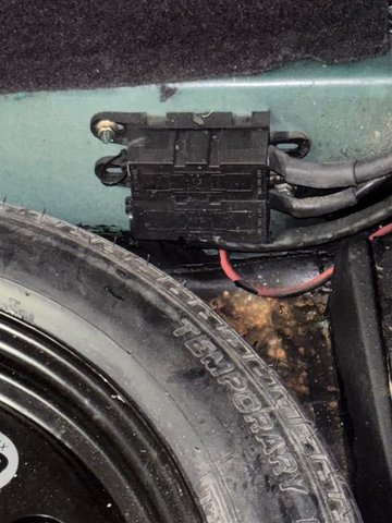

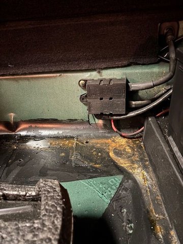

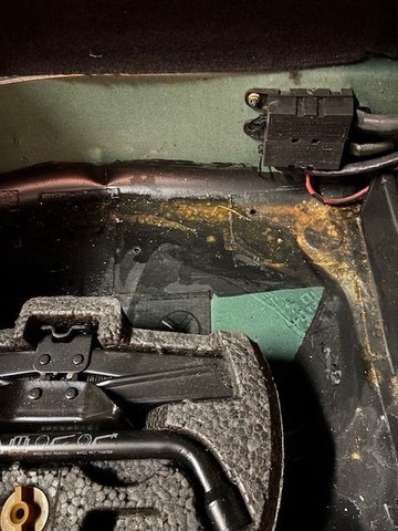

Took the spare out of the car and this is what is in there. I'm guessing the little black box is the HPPM. There appears to be some water on the floor just under the box. I've checked the weatherproofing around the trunk and it all appears to be intact. Is there any other place this water might have come from?
I'll get the cover off and take more photos and dry everything out. Same with the battery terminals and connections. Then I'll head to the engine compartment and see what I can find.
Joe

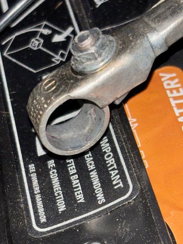

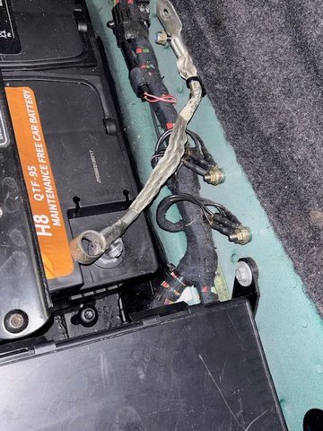

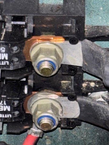

Got out my handy dandy 10 wrench (spanner) and here's what I've got:

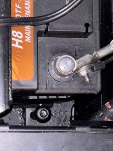

Negative terminal and cable:
Positive cable and terminal:
HPPM

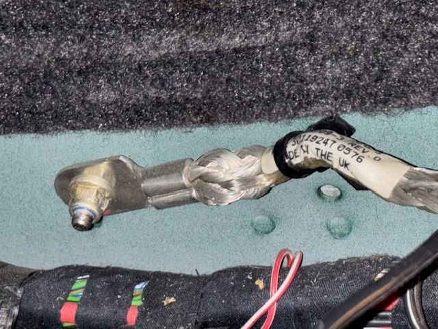

There is also this set of ground attachments along the same wall as the main ground cable, I'm guessing I should remove them and clean them up too:
