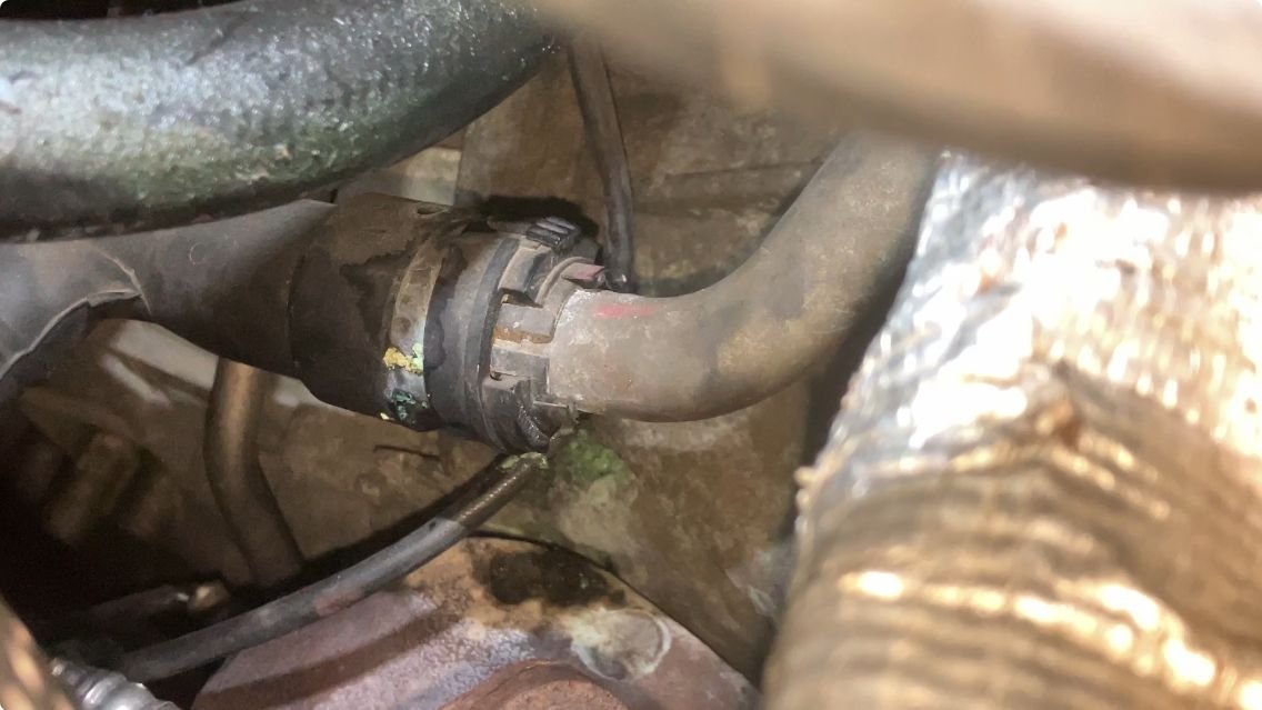

Originally Posted by sanchius
The task today was to track down my coolant leak while the weather was still warm.
I'd been losing a little bit of coolant each drive and getting that familiar faint maple syrup smell lately.
I was hoping it wasn't the hoses under the supercharger as I already have 2 other projects going and would rather not get that deep into the engine.
I put the bonnet in service position (disconnect the two struts and use two bolts through the hinge holes to secure it in the the far open state).
I hooked up my HF coolant pressurization tool, pumped it up to 1.2bar and was quickly greeted by a drips of water coming down the front case of the engine.
This was heartening as it meant I could easily reproduce and track down the leak on a cool engine, as opposed to it being from something that only leaked when hot.
With several vintage cars in the fleet, I find myself using this pressure test tool often, either for this or for pressure bleeding brakes and clutches.
See: https://www.harborfreight.com/radiat...kit-63862.html.
It was impossible to determine the source, so I removed the aux & SC belts, the radiator fans, one of the idler pulleys, and got out the bright lights and mirrors.
I find I work better when I have adequate light, so I like to hang a bright 4-foot LED shop light off the bonnet to shine directly into the engine bay.
I quickly discovered an easy one, a hose on top of the engine with the spring clamp in the wrong place (red arrow)..
Strange, I don't recall ever touching that clamp, but it's hard to believe it's been that way for 2 years.
X100 2001 XKR pressure testing coolant system
I was still getting coolant drips after I fixed the clamp and re-pressurized the system.
I removed the water pump pulley to see better and the second source showed itself to be coming from the underside of the water pump.
It looks like a simple fix. A replacement pump has been ordered and should arrive this week.
