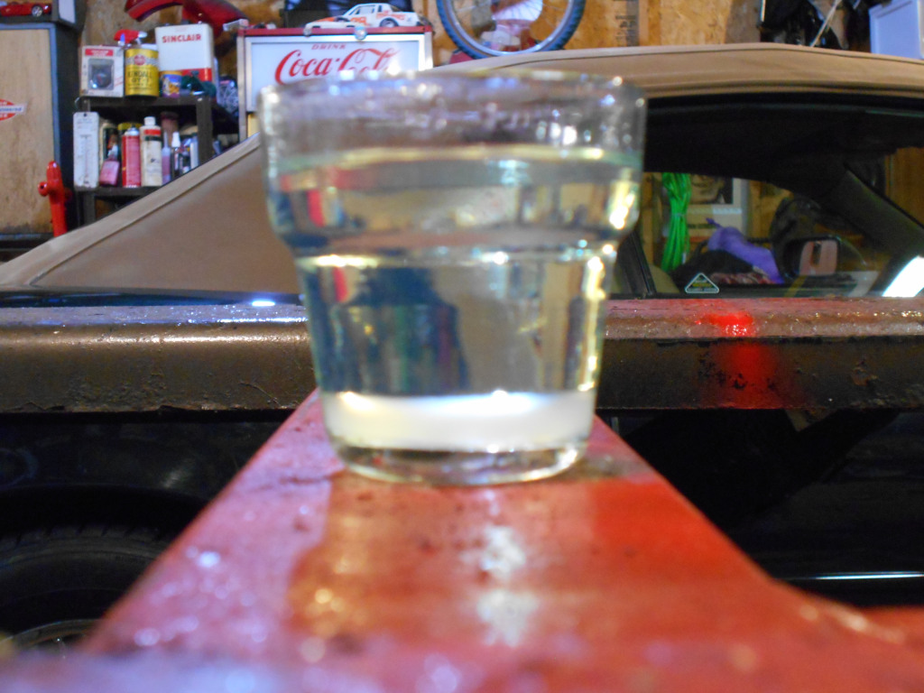

Alas.....It was water in the fuel. For those of you that need to see what this phenom looks like, I will try to put up pics later. It doesn't take much to screw the pooch.
The amount of water you see at the bottom of the glass, is much more, percentage wise, than it would take to pop a code, or even stop an engine.
This is just what I wrung out of my wicking, that I had laying at the bottom of the gas tank. I just put the picture up here for those of you who never saw what gas and water look like, once they separate......Thanks....Mike
