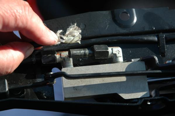

Just thought I would show a couple of pics
Attached Thumbnails Oil leak from latch on a convertable-roof-hose-fail.jpg   Oil leak from latch on a convertable-roof-fail2.jpg

I wonder if anyone can give me an idea on how to flush the convertible roof hydraulics, is there a specific procedure? I'm curious because I am about to renew the hoses and I dont want cross contamination of the fluids.
many thanks John
Old May 24, 2010 | 07:30 PM
Gus's Avatar
Gus
Joined: Jul 2008
Posts: 11,356
Likes: 2,236
From: Berlin Md.
I put a procedure on my page that I would use. It is an abbreviated version of the one from Jaguar. http://www.gusglikas.com/AutoRepairHydHose.htm
