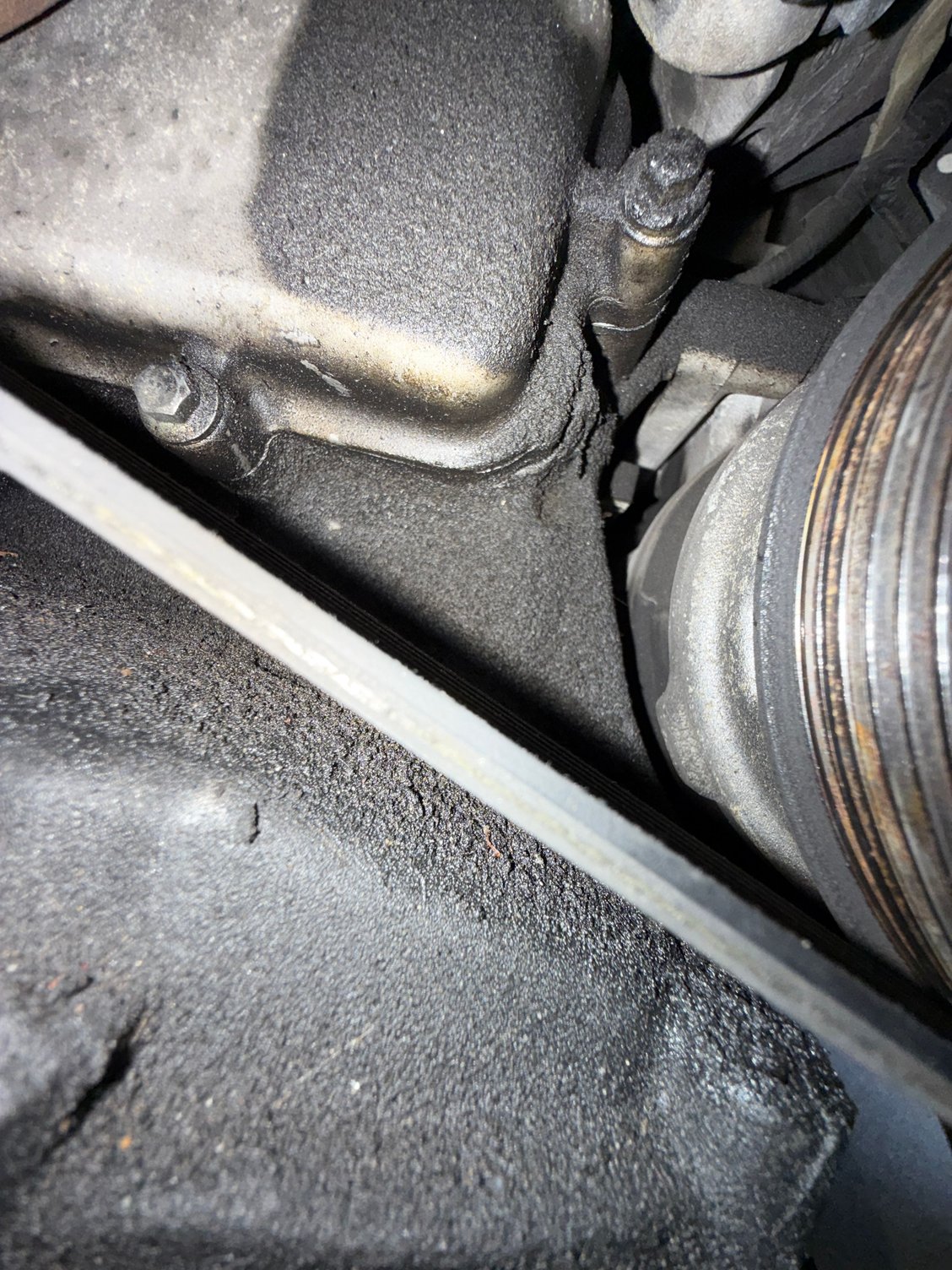

In replacing the oil cooler and hoses on my 2005 XKR, I noticed an oil stain on the engine. It appears to be caused by oil seeping past one of the bolts (photo attached). Assuming this is the case, is this something I should worry about? Can I fix the problem by removing the bolt, applying Loc-Tite, and re-inserting it? Other suggestions?
Oil seeping past upper-right bolt.

It's the timing cover gasket, not the bolts. Yes, do take the opportunity to change both timing cover gaskets, the harmonic balancer seal, and valve cover gaskets (they have to come off anyways).
