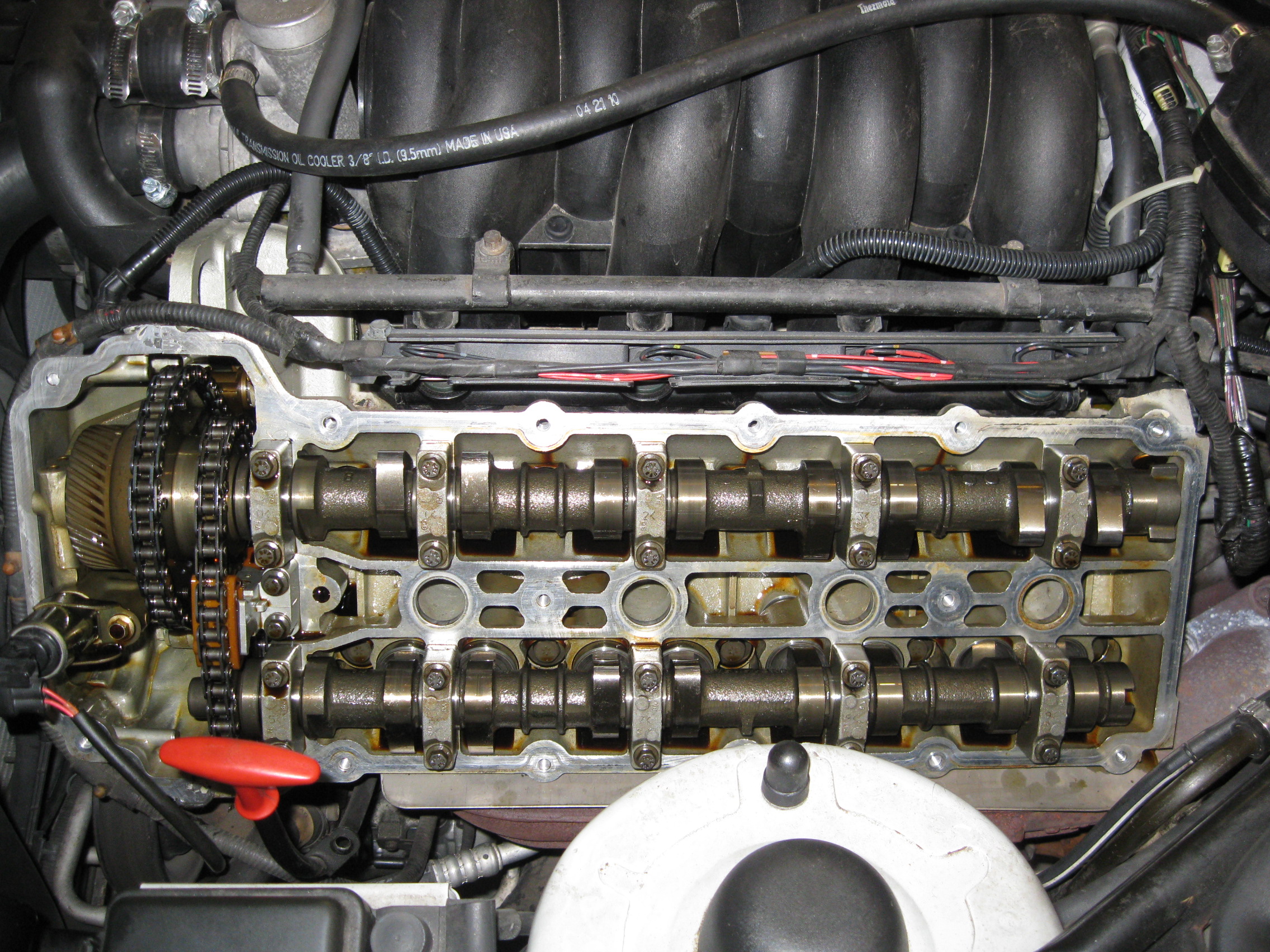

A little something to read - Bob is the Oil Guy - Bob is the Oil Guy
I personally am not in favor of going higher than 10w-30 but that is my preference.
I recently removed my valve cover to inspect the tensioners and I am attaching a photo of that.
