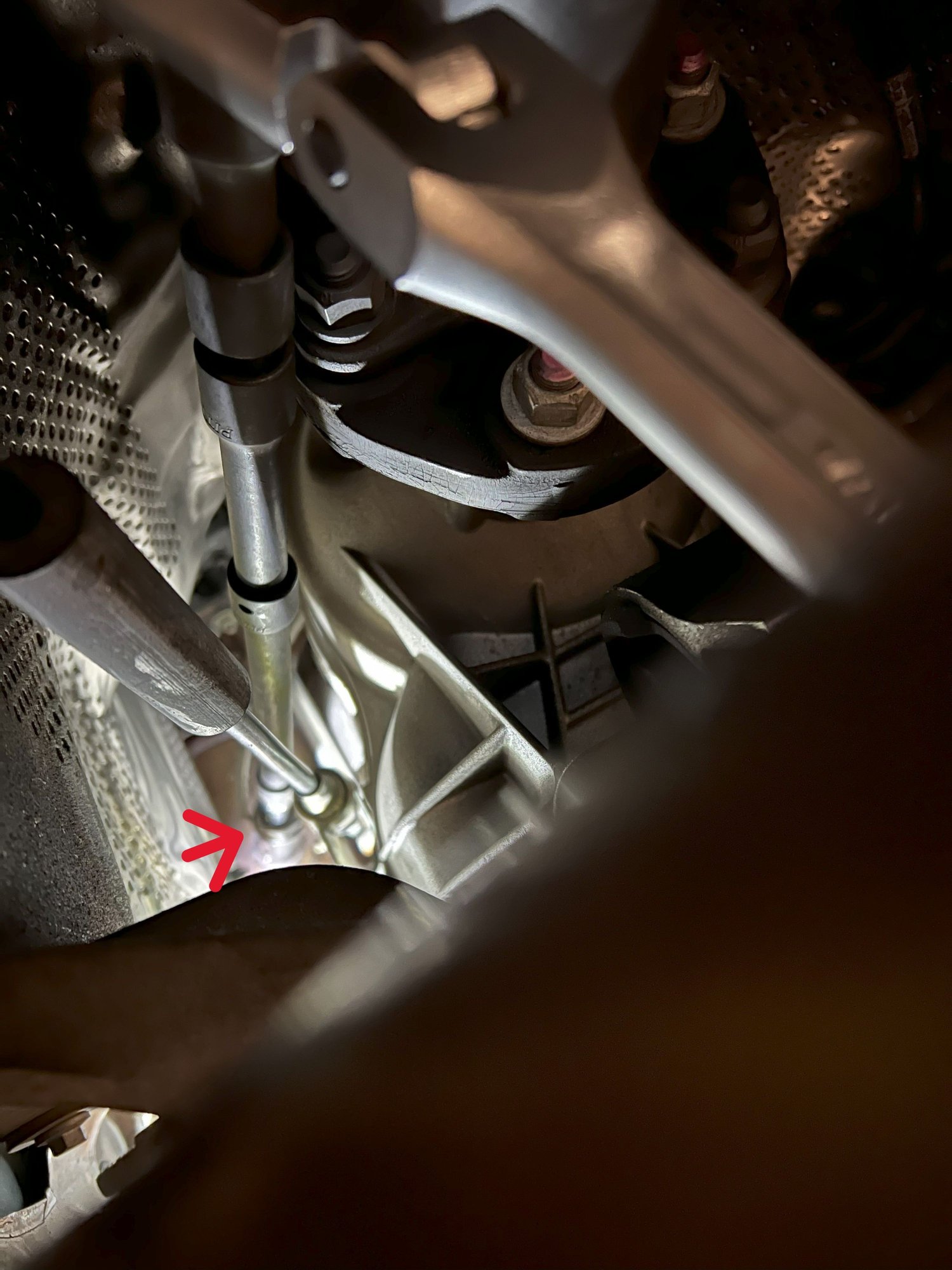

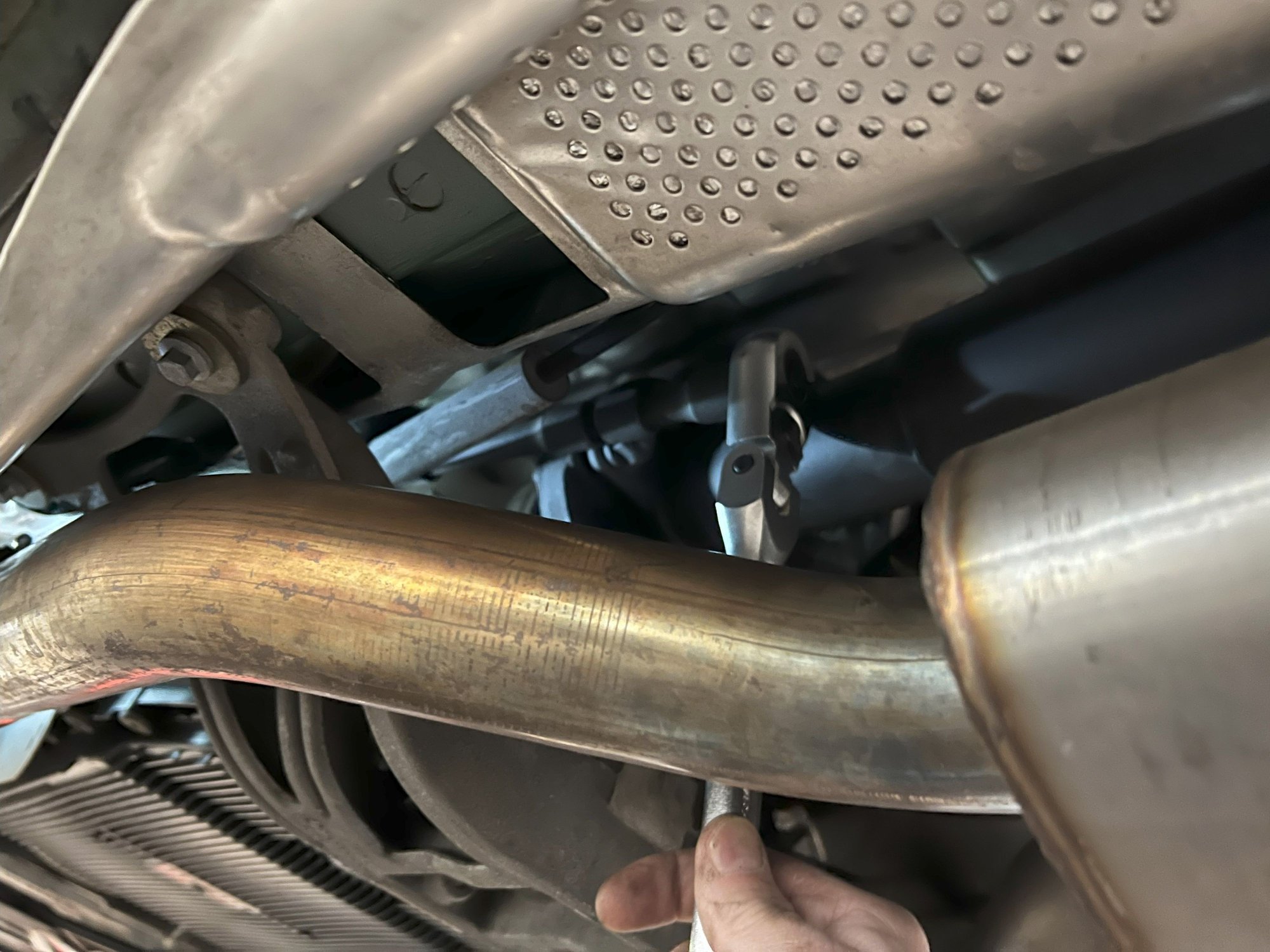

I found some good threads and tips about getting the downstream 02 sensor out without removing exhaust parts. While I was under there I kept stacking on extensions and found you could actually get a dead straight shot, but with a solid 24" of extensions, so probably want 1/2" at least for the torsion. But it worked great first try for me, but my car has been babied so it wasn't a bear to crank out. Anyway, something to try. Once you get as far back past that driveshaft flange, you can fit a big 1/2" breaker socket up there (probably too much torsion flex if you just have a breaker bar and no ratchet) and not have to deal with flex sockets.

FWIW, on the earlier car, there is supposed to be a straight line to the downstream O2 sensor from the A/C drains. Never done it myself, but it has been mentioned before.
Best of luck, keep us posted.
