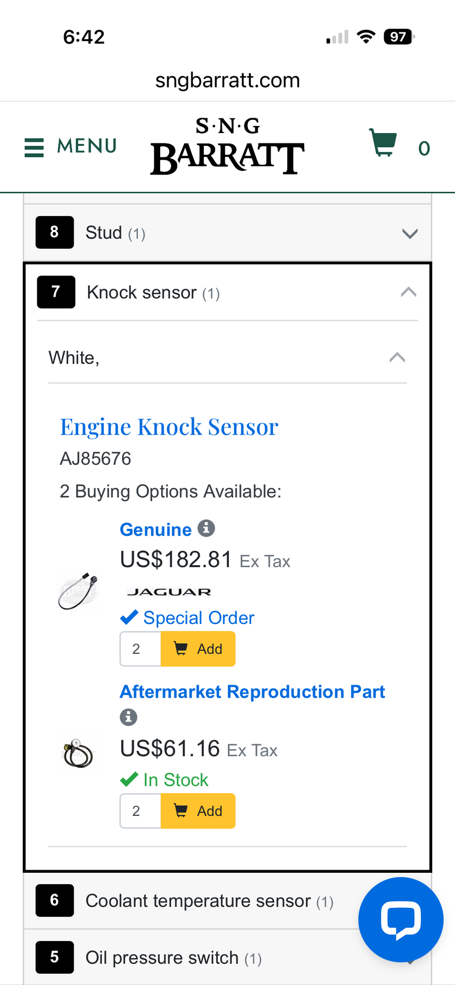

SNG Barratt has the OEM sensor for $182. Maybe worth the OEM price since replacement takes so much effort, (as mentioned, the supercharger has to come off to access the sensor).

2004 XKR
