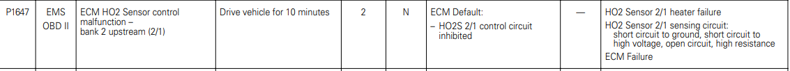

There is first time for everything. After 102K miles I got my first check engine light. Hooked up the reader and got a P1647 code. My list says "Linear O2 sensor control Chip." (bank 2) Chip? Is that like printed circuit chip or some other ambiguous device? Or is it just the sensor itself? Any help would be appreciated. Also, Just in case I have to change the sensors are the 4 sensors the same part? I'm inclined to change them all after all this time, No sense tempting fate!

The tool has non-standard, bad, wording. Imagine it with control Chip deleted.
You can look up Jaguar's meaning (free download) and they list all possible causes - though it's likely the (single) sensor.
They're not all the same and as proper ones are not wonderfully cheap I'd change just the one or if you like both sides.

This is the driver side wideband/upstream O2 sensor. More than likely needs to be replaced, but you can check fuses and relays to be sure. Get a good quality part, like Denso. Sensor is driver side, under the coolant expansion tank (will need to be removed or set aside for access). Sensor should be reachable from the top, I used a crows-foot O2 tool. As usual, these can come off sort of easy or be a real bear depending on corrosion. If it comes to that, cat is not super hard to remove (again, depends on corrosion). Plug to the sensor is on top of the transmission, behind the throttle body. A bit of a pain to reach, but nothing extraordinary. If you decide to remove the coolant expansion tank, a turkey baster tool does a great job at minimizing the mess.
Normally, all 4 sensors are heavily monitored by the ECU for emissions purposes so folks normally change these sensors as needed, i.e. with codes. They are not cheap enough in my book to just go ahead and change all 4, and there is no real time saving in doing all 4 at once.
