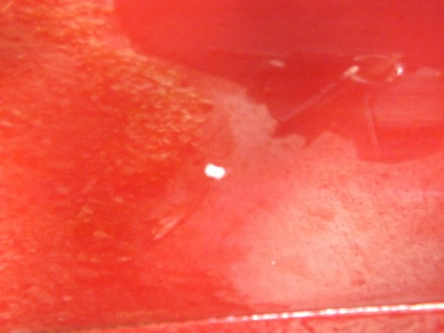

Here are a few before and after pictures. I followed the EZ Chip directions exactly as suggested. The first shows a reasonably large "white" chip while the second shows it filled in with a lighter red color overlapping the edges of the chip and clearly not filled in. This was after three applications. Really no better than just buying a little tube of touch up for about a third of the price and dabbing the chip. Maybe Dr. Colorchip is a better product.

Some hardening time followed by blending in with a random orbital will make it almost undetectable. Definitely an improvement on the base coat 'before' pic.
I've tried the Farecla Scratch & Stone Chip Removal Kit before. This looks to be very similar to the EZ Chip Repair Kit you've used.
I came to the conclusion that a batch of colour matched touch-in paint from my local autoparts supplier would be as effective and considerably lower cost. Subsequent tests proved this to be right.
