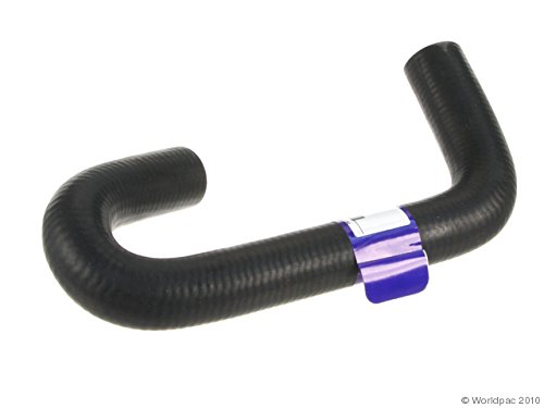

The heater return hose is just old (and a bad design) and when the throttle was adjusted, leaning on it caused it to kink/collapse semi-permanently.
Initially, it appeared electrical since the center instrument bulbs both went out at the same time. Thinking back, it was just a coincidence. However, checking the electrics did lead to the replacement of the ignition relay with a new one.
A return hose from the supercharged version (that has a 180 degree bend that is molded round rather than flat) is on order. It was $11 compared to $93 for the XK8 hose.
It will need to be cut in half (the 90 degree bend removed, and possibly used on the other end of the check valve, routing it to the outside of hose 5 rather than inside of it, so the top hose can approach the heater core at a better angle) and the hose that connects the shut off valve to the check valve will have to be rotated/shifted slightly. It should work better than the original. If not, then the $93 hose will go in.
