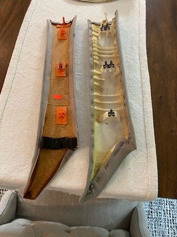

Wont work, I have one that I ordered on eBay. Going to use the original with a little help from super glue. Will take some pics when I get home from a business trip

As you can see from the pic, the original (on the right) has 2 clips vs one and also the one side has a sharper corner and a little longer

After all I went through I broke one of the clips getting it on, had a gap and put the rubber hammer on it “gently” and it fit nice and snug.
