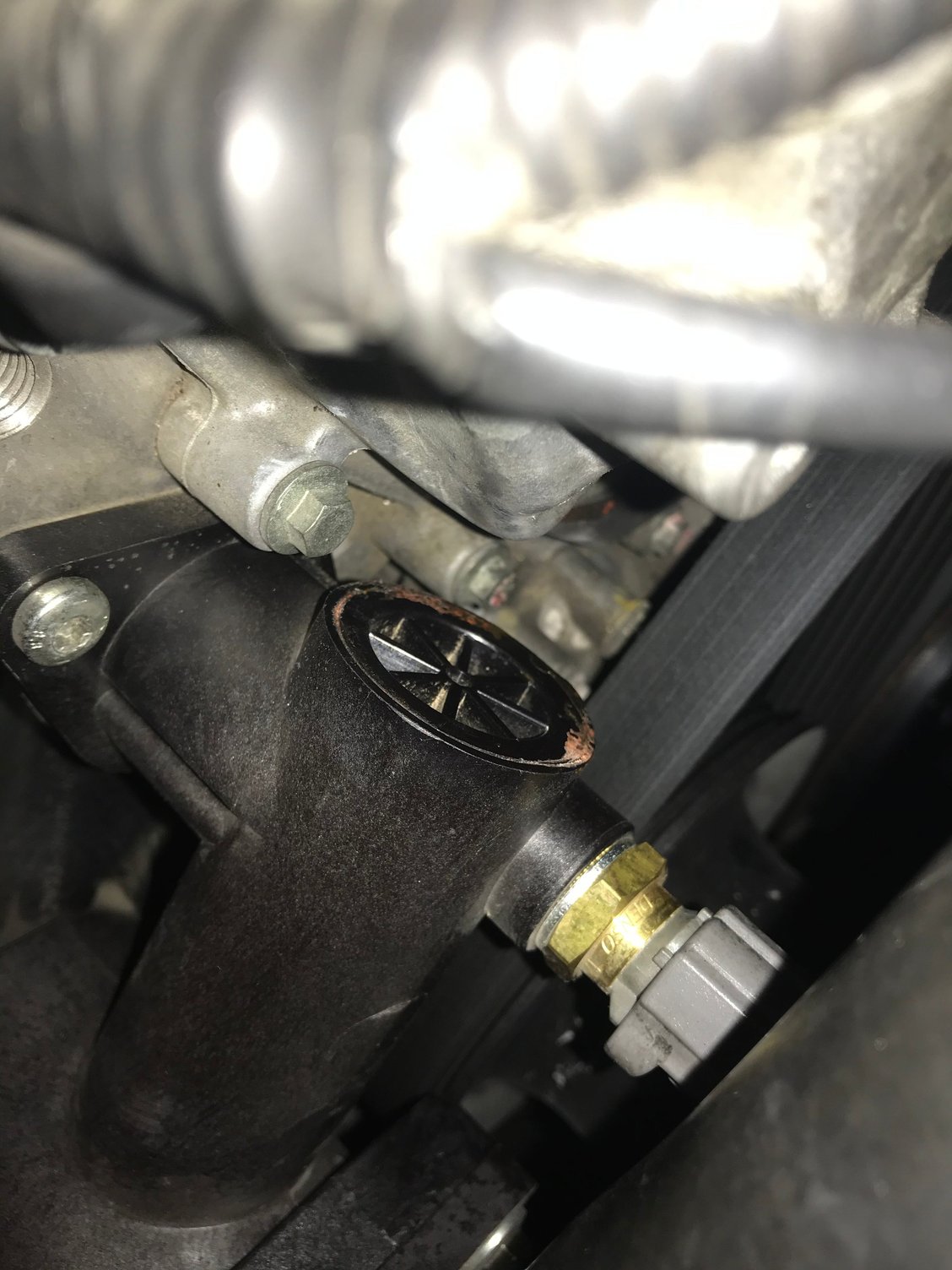

This is on a 2006 XK8, with 4.2L engine: on the plastic thermostat housing there is what looks to be a plug of sort, on the far left side, nothing connected to it. There is a small coolant leak here.
I have replaced the entire assembly once already some years ago; am I really looking at replacing this again? Or does this "plug" unscrew and just needs a new O ring? Not sure how I would ever get this "plug" out, not like it has anything that any tool I have will work.

Decided to do a "got nothing to lose" approach.....cleaned the coolant off, applied RTV in this area.....will see.

First attempt of the RTV "fix" was not 100%, had a very small leak at the very bottom of the plug, Cleaned-off, applied RTV to this area. Will see once again.

I doubt that will work with the cooling system under pressure. That may be a plug that fuses by friction from spinning.

As expected the RTV "fix' did not work. At the bottom of the "plug" circle there is a raised area that coolant continues to drip-out, almost like a weep hole in a coolant pump of past. Tried applying RTV inside this, but no luck. Looks like replacement (again) is the only route. I checked my logbook; replaced the thermostat tower/housing in Sept of 2017 at 74386 miles; less than three years and 25k miles......crap parts.

I don't think there is an aftermarket one. I replaced mine three years ago and again less than a year after, both times because they leaked along the molding seam at the top.

Another quick update here....no the aluminum thermo kit does not fit the 4.2L engines. It is now listed in the Marketplace.
Getting another plastic outlet pipe, getting it from Terry's Jaguar Parts.
