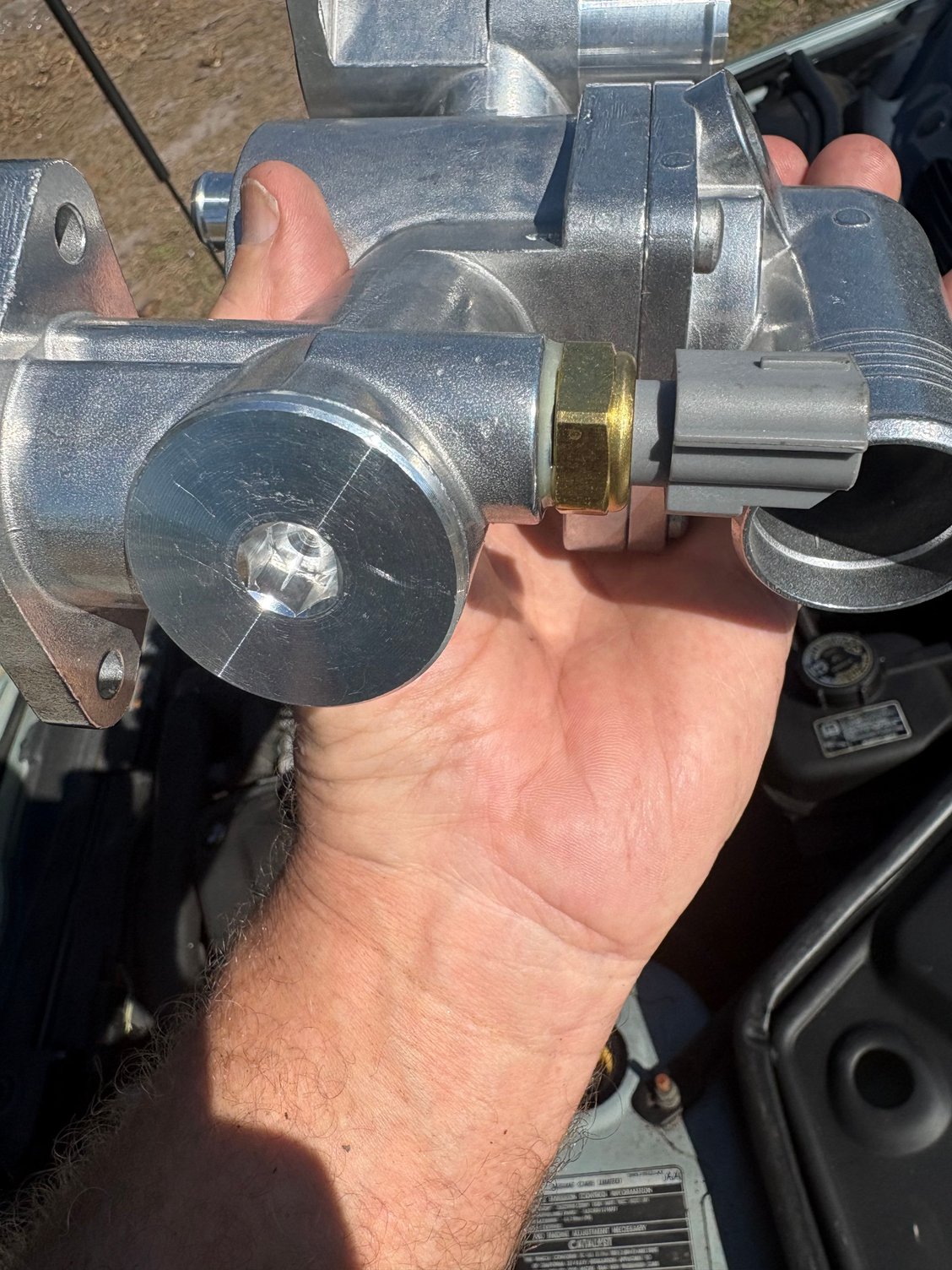

Looks to be an exact fit.
Comes with temp sensor
Comes with thermostat

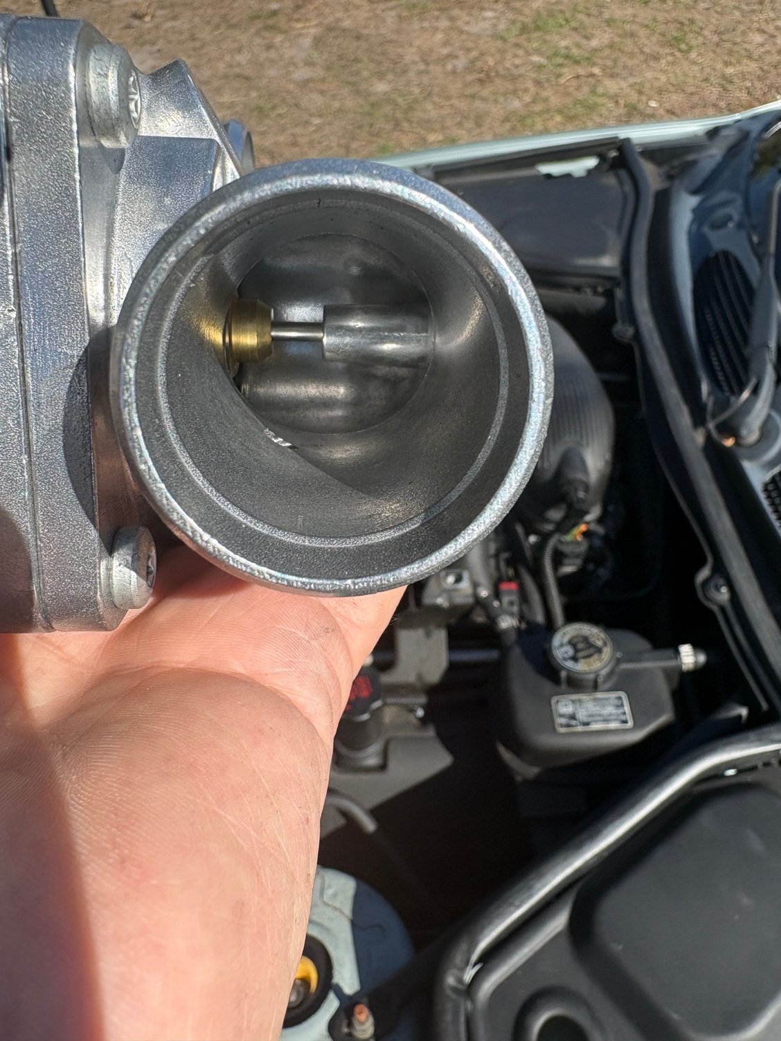

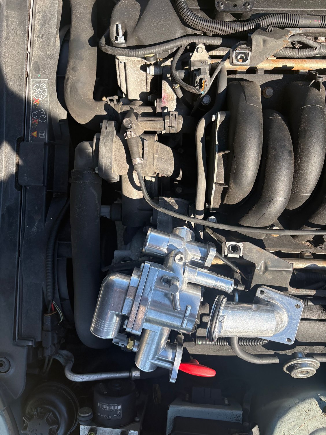

Just got the Mitzone 4.2 aluminum thermostat housing. I will install after I finish performing a flush.
Looks simple enough except for a clearance problem with the front two torx screws. It appears if I remove the intake front cover plate I should have enough clearance.

The 3 pcs Stat is difficult to install and remove. We made a slotted tool from 1 1/2 pvc fitting cap and it made easy. I know my existing stat works along with the Temp sensor. Unknown of the import quality of these parts. I will transfer my good parts. That cover o ring is ok if not brittle. A lite wipe down with Hylomar sealant will make a seal.

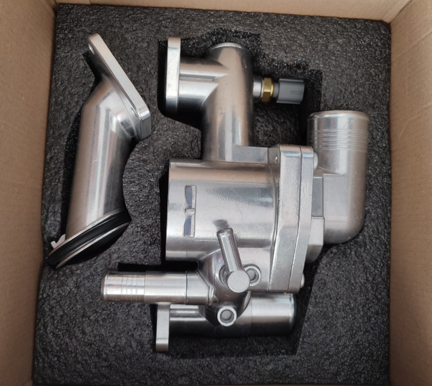

Here's what I just received from Mitzone via eBay for the XK8.
As you can see, it's almost packaged like an anniversary gift (only the box is more like a gift box). Beautiful. I hope it lasts a long time.

That is a very good looking item. Please let us now if you encounter any install glitches and how resolved them? The 2 fasteners under the plenum cover may require removal of the cover, if O-Ring is pliable and undamaged coat with Hylomar in re use. Hope all goes well!

I have the same Mitzone part(s). Look to be very well made. Pretty nice casting and finishing work. Haven’t installed mine yet though, so anyone who does so first, please report back to everyone!

I just the replaced the thermostat housing on the 4.2 with aluminum.
