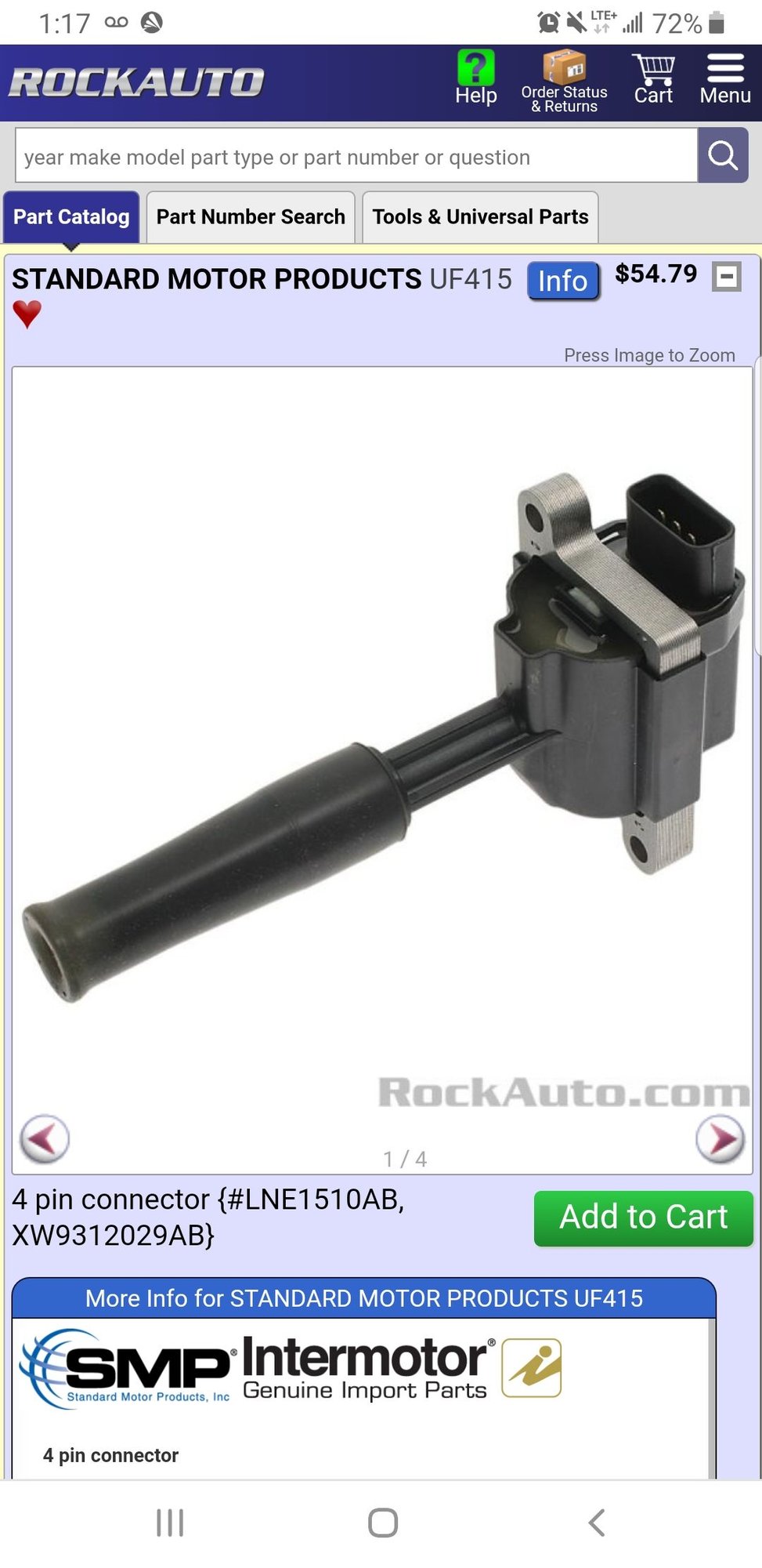

Bought original equipment from Jaguar Victoria. There were 2 to choose from and I picked the one resembling the ones from my 4.0 S Type. Part # AJ810445 for my sn 36813. Anybody know if I guessed right? Dealer not overly helpful. They only want to sell new F Types.

I bought delphis for my 97 xk8 on rock auto for around $50 each. The main difference with the coils is that the earlier cars used coils with 2 pins and after vin 031302 they switched to a 4 pin connector.

I guessed wrong. The coil I need is like the one pictured in post above. Back to Victoria to trade in the morning. At $170, need to find better option for when I do them all!
