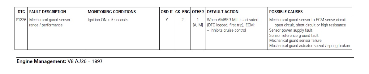

P1111 is always a good sign. It means OnBoard Monitoring Tests completed.
The possible causes of P1226 are shown in the right hand column:
I have no idea what this 'mechanical guard sensor' means!
However, the MIL would almost certainly have reset within the 45 miles you subsequently drove (the necessary two drive cycles being completed in less than this distance) so you can probably put it down to bad gas or an out-of-range signal to the ECU.

On the earlier cars, the mechanical guard in the throttle body prevents the electronically controlled throttle body from straying too far off course in the event of an electronic failure. It was a safety feature before they had full confidence in the electronic throttle concept.
If the problem recurs, there is likely a problem with the throttle body.
