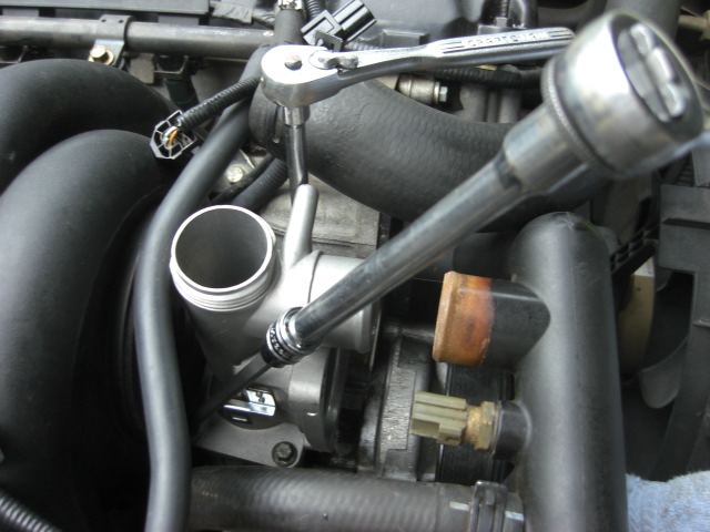

Getting ready to put a aluminum therostat housing on a friends 2002 XK8 and have read all I can on the replacement procedures and thanks to all who have gone before me and left their knowledge.
I had a hard time finding a 8 MM crow foot and took matters into my own hands. They should work a treat, one to break it loose and tighten up and one to get the bolt out. I will use the short bolts in the rear.
Someone over tightened the housing at the thermostat and it's now leaking and unable to tighten it up, spinning in the housing.
Wayne

Nice tool fix cjd777. I assume the bend will clear the space.
I have read most of the threads on this repair and the suggestion is always to slot the new bolts to make it easier next time. My question is why not use allen head bolts? Surely these are common enough bolts a good supplier could match it up.
If the replacement is ever needed on mine, I intend to try this unless someone else beats me to it and says it is a bad idea.

Just a thought but here might be more 'spring' in that length of rod than would allow the bolts to broken loose. Several have used cap headed bolts to put it back on. Metric 8mm cap head bolts might be a little hard to find at your local ACE Hardware but I am sure they are available.

Nice work CJD777,
it took me a couple of weeks to find an 8mm crows foot. Your idea should work if you can get enough torque. I replaced the bolts with cap heads from the local auto parts store, to make it easier if I ever have to replace them again.

Thanks to all.
I think I may have found the allen key bolts at Lowes, if not I will get something that will work a bit better than what is there, even if I have to slot them.
The long rods are quarter inch and good steel, if they would have a problem, I give up.
Wayne

First off Testpoint, there was a bit of give, in the tool when breaking it loose, nothing that gave me a problem .

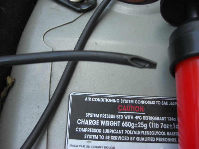

I used a different method of getting the antifreeze out. I used a hand pump extractor in the reservoir then removed the cap on top of the thermostat housing, got as much as I could with the large hose, taped the small hose inside and cut a point, working on the side of the housing you can get it by the thermostat itself and down in about a foot. Takes a while but no mess, IF you remember to tape the hose that comes off the thermostat cover to the top of the radiator, it will dump a goodly amount before you can say dump ***. See picture below.
I wish I could say all was routine, but I was going for a easy way and trying different approaches to see what I could come up with. The box end of the tool set was the better chose in getting the rear bolts up until the intake would not let the tool come out, at that point the open end did work, but I have a 8 inch pair of needle nose pliers that worked much better, but I have done this for years and it might give others a pain, (in the hand). I don’t recall if others removed the outlet pipe, but it makes getting the short top hose off worth the two minutes to get it out of the way, be careful with the seals, I should have got new ones, so far all is well.

The parts to make this a easy install were all found at Lowes :
Short bolt, socket Hd cap screw, class 12.9 M6-1.00 x 20
Long bolt, Socket Hd cap screw, class 12.9 M6-1.00 x25
# 10 washer was perfect size,, but needed to be hit with a ¼ inch drill, the socket head screws did not have a good flat area like original.
5 MM ball hex driver socket, 3/8 drive and 6 inches long
Turns out, I only used the short ones at the rear, as nothing is wrong with the front. Put the short ones in the housing and set it back in place and start all bolts by hand. Be careful on the torque. I did add a drop of high heat lock tight to each bolt.
The rest if just routine bolting up and fighting the hose clamps. Adding coolant at the top of the housing while giving the hoses a gentle squeeze will get most of the air out. Give yourself some room in the housing so your pumping won’t overflow. Don’t forget both large hoses and the small vertical one.
I did get a knock sensor code, but the one with the chip out needed some cleaning and all was well. Hope this will help, yeah I know, most should order the top hose and new out let seals when getting the housing kit.
Oh, one thing that was a bit concerning, the housing set back so as it was touching the crossover fuel rail, I’ll keep and eye on it for scuffing.
