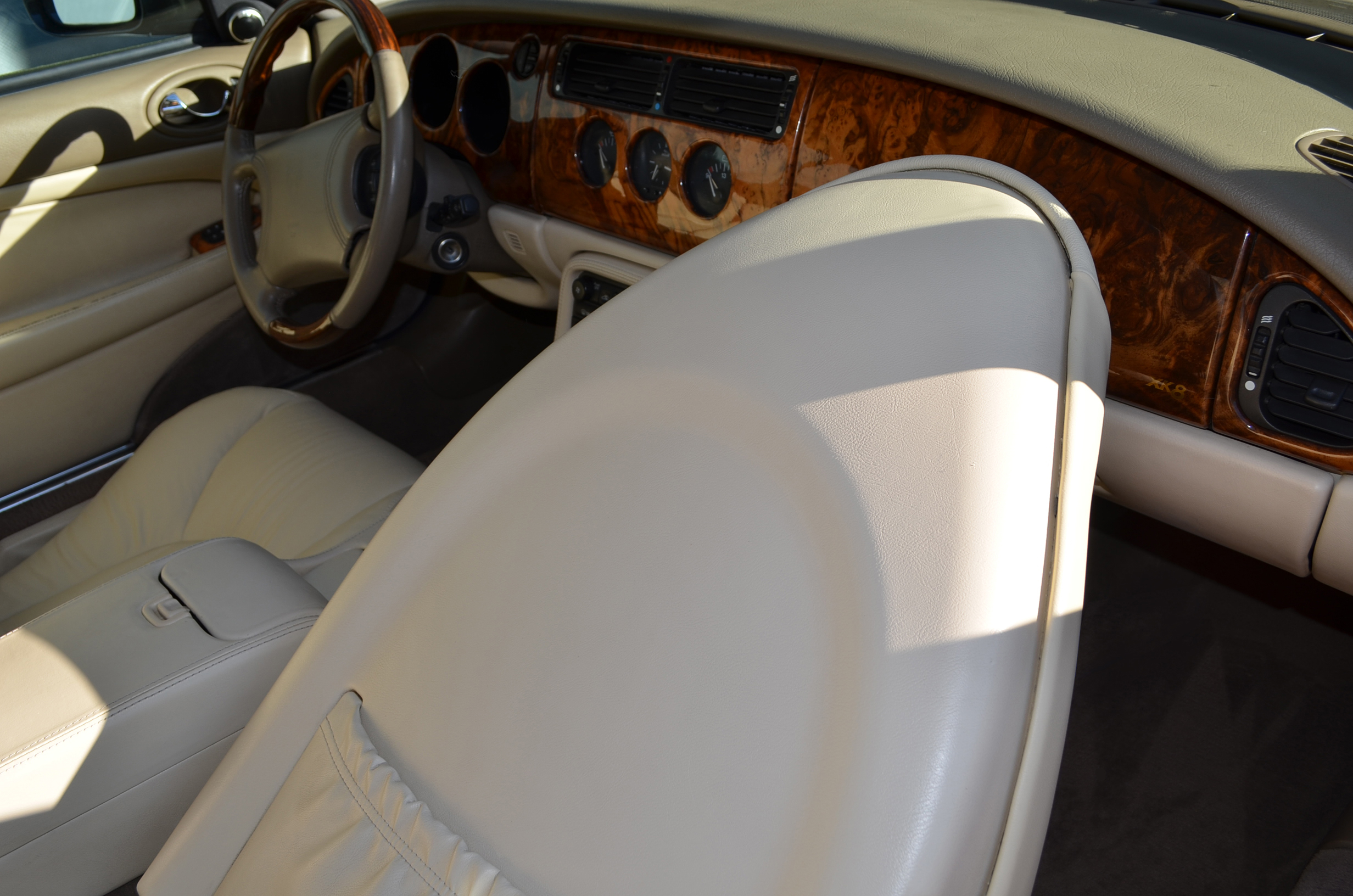

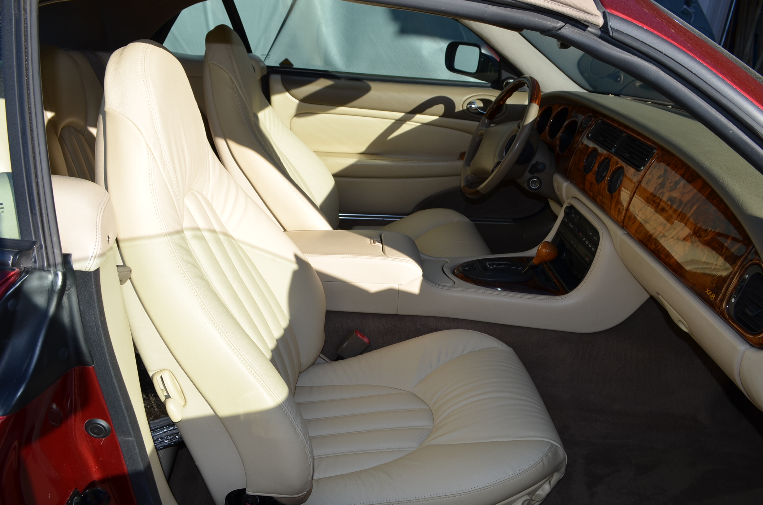

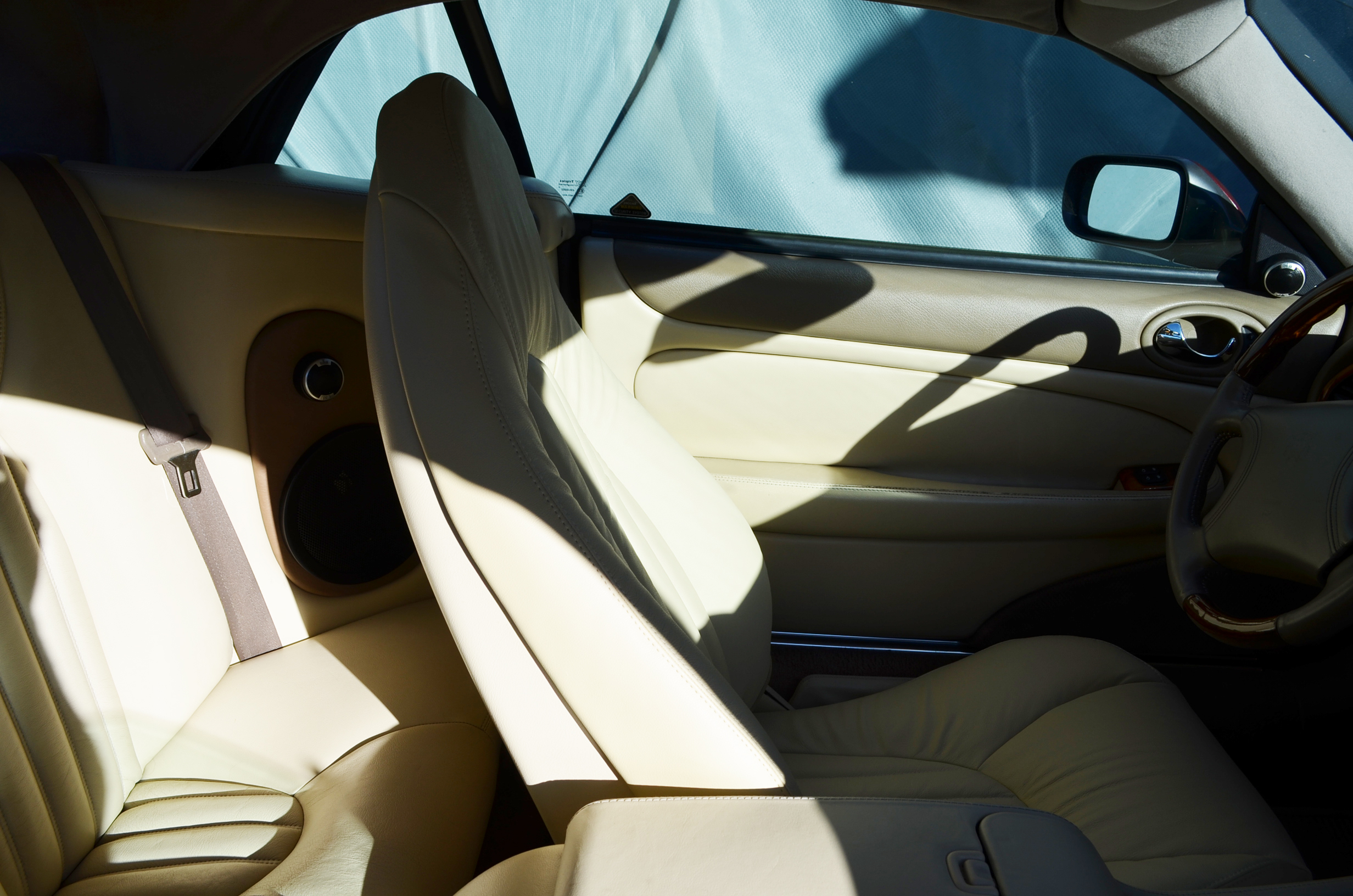

Can you post a few pictures of your seat backs?......Thanks.....Mike

The first is the before shot, the four are after shots.

Here's the pics...
Attached Thumbnails Put to rest: Replacing Leather Seat Covers-1.jpg   Put to rest: Replacing Leather Seat Covers-2.jpg   Put to rest: Replacing Leather Seat Covers-3.jpg   Put to rest: Replacing Leather Seat Covers-4.jpg   Put to rest: Replacing Leather Seat Covers-5.jpg

As you can see from the last shot, compare the switch plate to the leather, perfect color match. Also to the center console as well.
