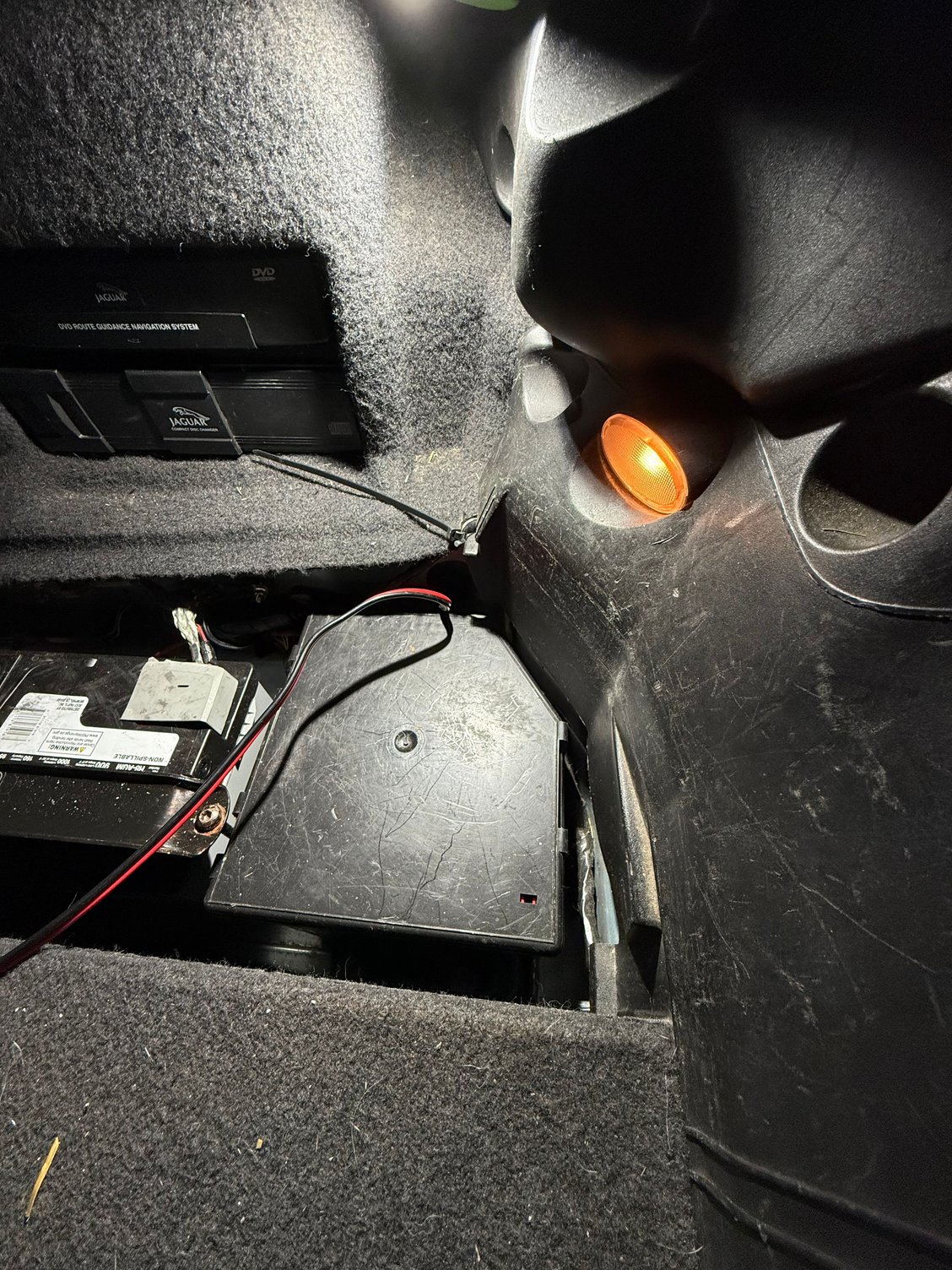

I dug a little deeper (literally) and found a cable that had come adrift from it's clamp behind the trim at the rear of the trunk. Tucking that back where it belongs did the trick. Thanks for all the suggestions.

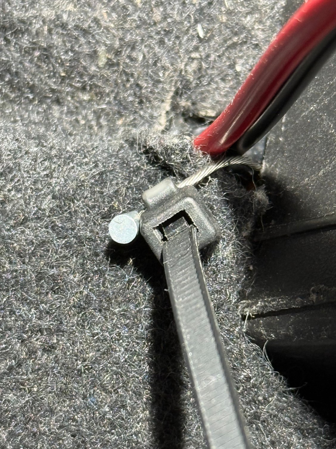

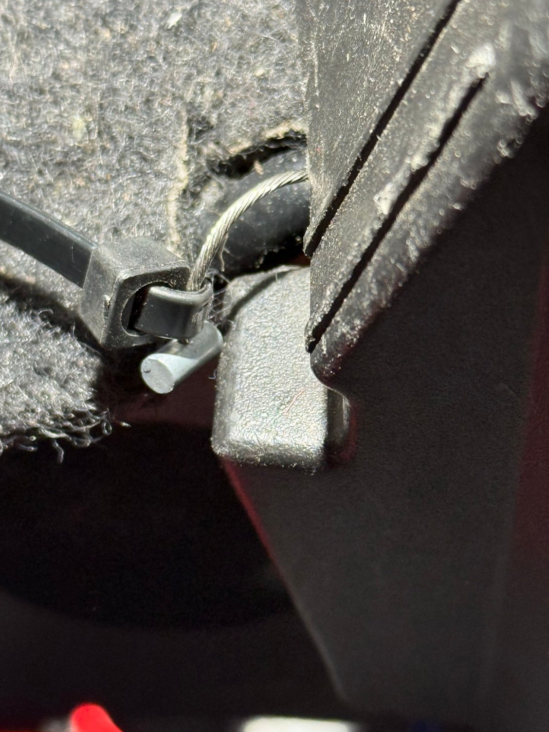

Don’t know if it’s this cable you are seeing, I doubt it. But there is a small cable on the battery side that is supposed to protrude into the boot / trunk space. It’s for emergencies if one finds oneself locked inside .
Like you were working inside of it and the wind blew the lid shut. Or you were being kidnapped Etc.
my cable is rather short, so I attached a zip tie.
The owners manual shows the emergency cable with a handle, and in a different location (for the convertibles ???).

No, that's not it. It was an electrical cable that runs along the bulkhead behind the rear seats.
