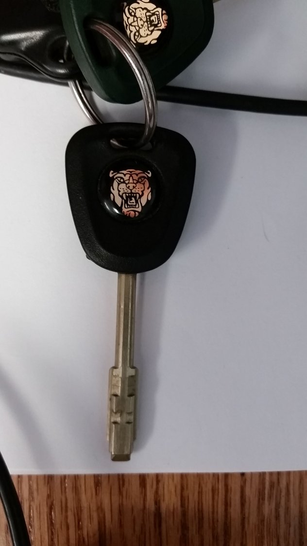

Here is a pic of the key cutout from my '97. It does not have a transponder (no visible pocket in the back).
Does anyone know if ANY key will work in ANY 97? That can't be right, right? Surely the cutouts would be different from car to car...

Here is a link showing how to "decode" your key.
How To Decode Your Jaguar Tibbe Key And Find Your Tibbe Key Code - Car Locks and Keys
While it is possible that a used key might have the same code, it is unlikely.... but you won't know until you know the codes. If you can get a good picture of the used key, you should be able to decode it and see if there is a match. The key fob should be transferable to your car. You will have to program it ( and maybe reprogram any others you have at the same time). See post 8 in this thread
https://www.jaguarforums.com/forum/x...gramme-196704/

The key is definitely cut different than mine. I have ordered a key from carlocksandkeys
using the link for decoding the Jaguar Tibbe key. I don't know if the key has a transponder
chip or not. My original key does have the pocket for the chip but after reading motorcarmans
post and trying the aluminum foil trick that fmertz suggested I just don't know. I'll find out
when the new key shows up. Thanks for the link for programming the fob. I;ll definitely try it.
