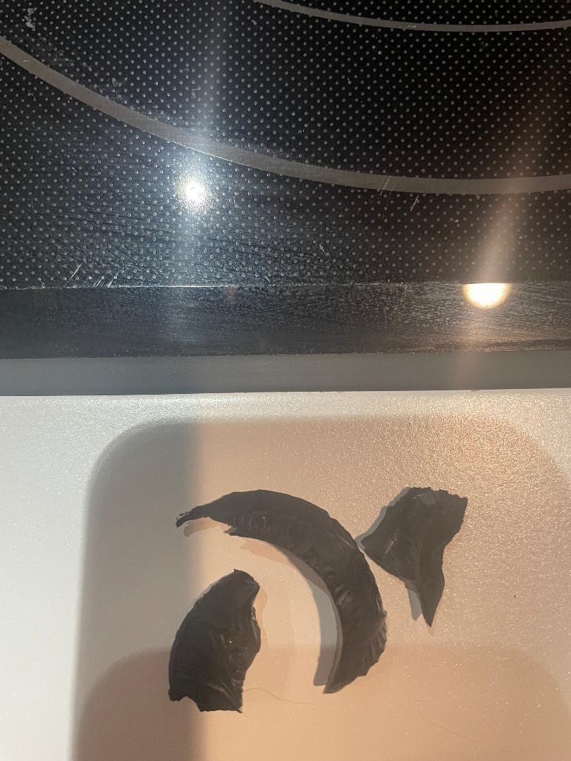

Greetings,
It seems my 2002 XKR is going to need another set ot these bushings as it's squeaking and clunking again. I replaced them in 2019 and only 13,000 miles ago with a Welsh Poly set. With this set, the rubber has not turned to dust like the original set did, but rather the rubber is still pliable but is breaking up. I included a picture of a few pieces of one bushing, and was wondering if anyone else had these particular bushings fail in such a short amount of time. I contacted Welsh, and they really weren't helpful in an explanation on this, and in fact no longer offer the Polly bushings for sale. The only option that they have and that was highly recommended is by Eurospare. I also see that Parts Geek carries this brand as well. Therefore I also wanted to get opinions on to whether you thought this was a decent brand, or is there another brand that's preferred? The bottom line is that I am willing to pay up front for a good quality set, in order to minimize the number of times I have to change these out.
Thak you,
Rob

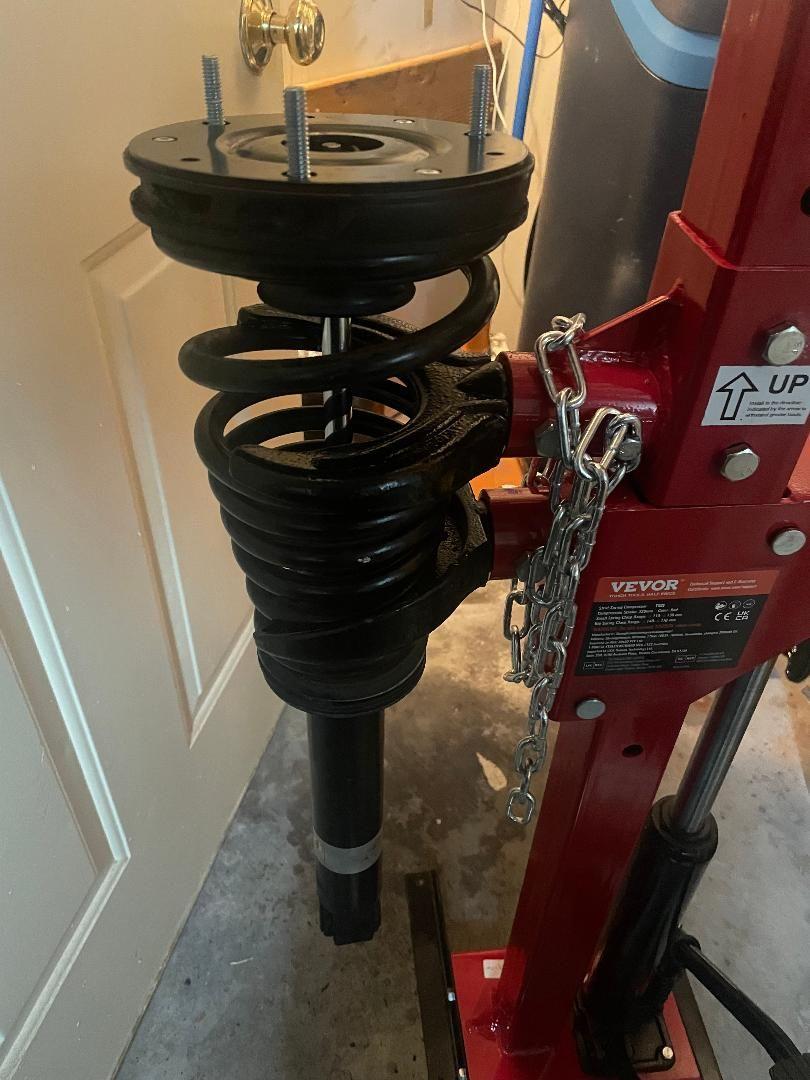

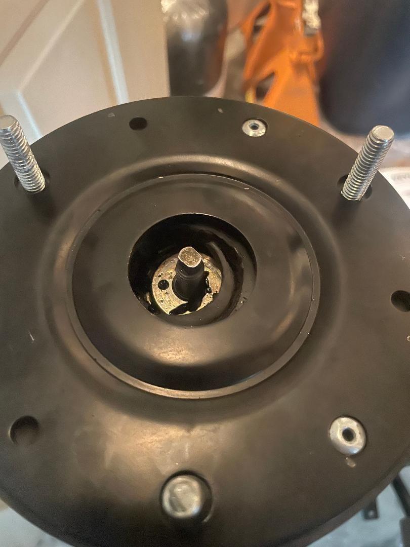

Hi Guys,
I'm reopening this thread for some assistance. Wayne, I'm trying to remove my shock mounts and get them into mail to you by tomorrow before I leave town for a week and a half. I have one side off. The spring compress sufficiently to where the upper mount is completely loose and can be spun by hand. But for the life of me, I cannot get this thing removed from the shock shaft. From what I've seen in videos, it looks like once the tension is off of it, it just pulls straight up. But again, even though my entire unit is loose, I just can't lift it up from the shock shaft. Even trying to hammer it down with a hammer and a brass punch does nothing. Is there something simple that I'm missing here? Thanks for any help with this and I appreciate it. FYI, these are not the factory mounts, but rather a set of the Welsh Enterprises poly units that I replaced myself about 7 years ago.

The mount "washer" (the disc in the top between the two bushes) is stuck tight on the damper shaft, many are much too tight, l always ream them a little and l know Wayne does also.
As to getting it off l suggest a press working on top of shaft with mount supported. Pounding is not being effective due to the bushes.
If you need more working space it is possible to compress the spring enough to lift the whole spring assembly including the lower spring seat, remove circlip on damper body and then drop assembly down. The top mount can then be disassembled more easily and a bearing puller used to remove washer.

Thank you Baxtor. When you say the disk is too tight on the shaft, or you mean the remaining portion of the rubber bushing is just stuck too tight to the metal shock shaft? And so therefore is it the rubber that I would try to ream out a bit further?
Regarding the press, I actually don't have one, and so if a press is actually recommended, I would likely need to take these to a shop. The first time I did this, I rented the spring compressor tool from the local parts house. I got it done, but that seemed a bit on the scary side if something were to fail, and since that time, I've ended up with the hydraulic spring compressor, which actually seemed to work much better as far as taking the pressure off.

The reaming out l mention was not meant as something you can do to remove it, it is something that routinely needs doing before reassembly.

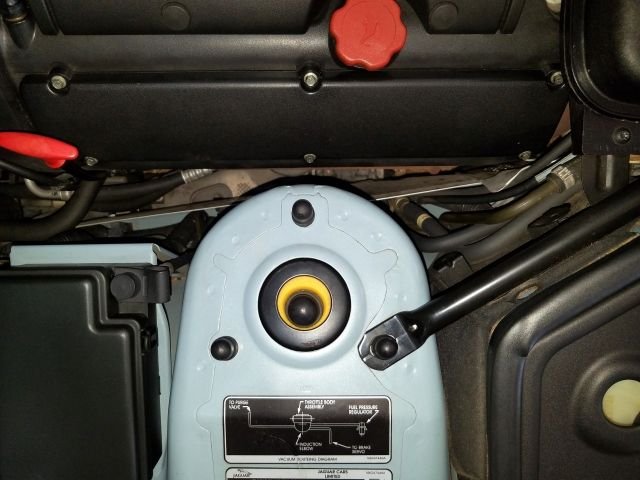

I hope I'm not hijacking a thread. But if I started a new one - I think "Question About Upper Shock Mounts" might have been the title
My 2002 XK8 had new struts and mounts a few years ago. I noticed today that the left side looks a bit off. I haven't noticed this before, so it might have been like that when returned from the shop, or it could be a recent development. Does this look like impending failure?
Left Side Wonky
Left Side Wonky
Right Side Centered
Right Side Centered
Comments welcome!
Thanks, Dave

Your damper shaft is 15mm diameter, it passes through a hole in the bottom of your top mount of about 25mm. This gives you 5mm lateral movement before metal to metal contact.
Par for the course with the URO mounts l am afraid, if you want a permanent fix message either CJD777 or myself.
