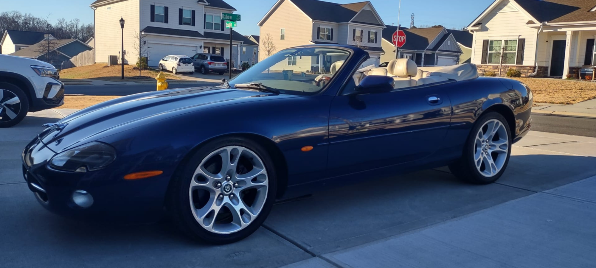

Hello Wayne, I'm in Mount Holly, found an email of yours in here and sent you a message.
Old and new, for what I read on this forum they won't last long
New to me 2003 XK8
New to me 2003 XK8

Welcome very nice car but, I'm partial to 03 rag tops lol. What struck me about your picture is that beautiful car sitting in a sea of white whatever SUVs and minivans. When did auto designers lose their souls and direction? Good luck with the car you'll love it, and the help and resources here for Jags is second to none on the internet.
