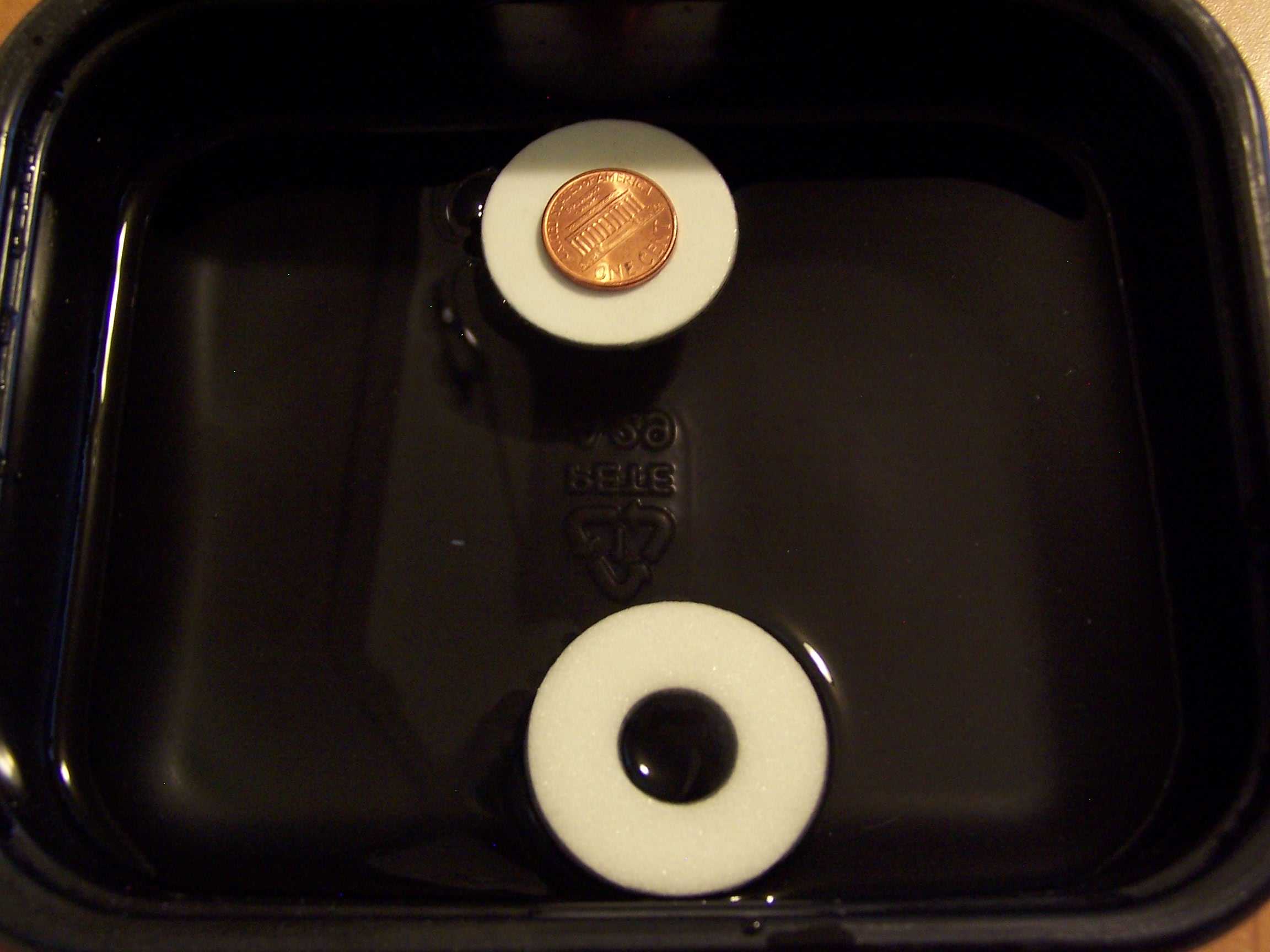

I used a foam ring from a DVD spindle under the float. Still working. Search for "low coolant message -resolved".
Attached Thumbnails Quick (hopefully) question about coolant level switch.-coolant-float.jpg
