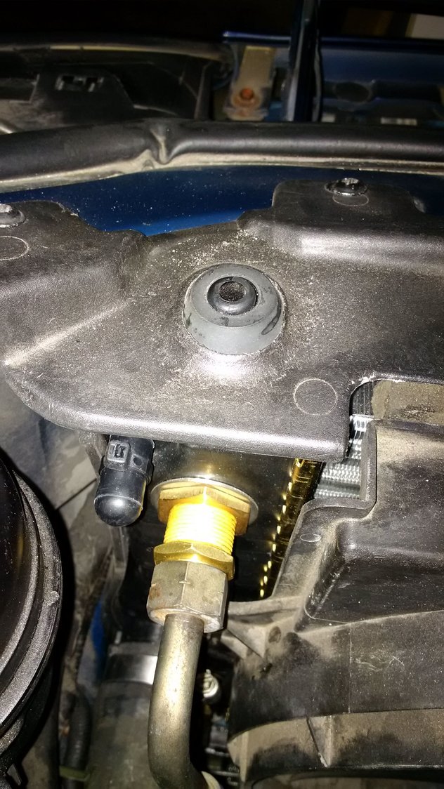

I replaced mine with a Nissen's as well. Get a mixed set of gas line caps as one port on the upper left corner of the radiator is not needed and will need to be capped (see pic below)
Not sure of the car details of OP but on my 2000 XKR that radiator nipple is used. I think there are differences between the 8 and the R as well as a change in cooling system breather lines early on in production.
