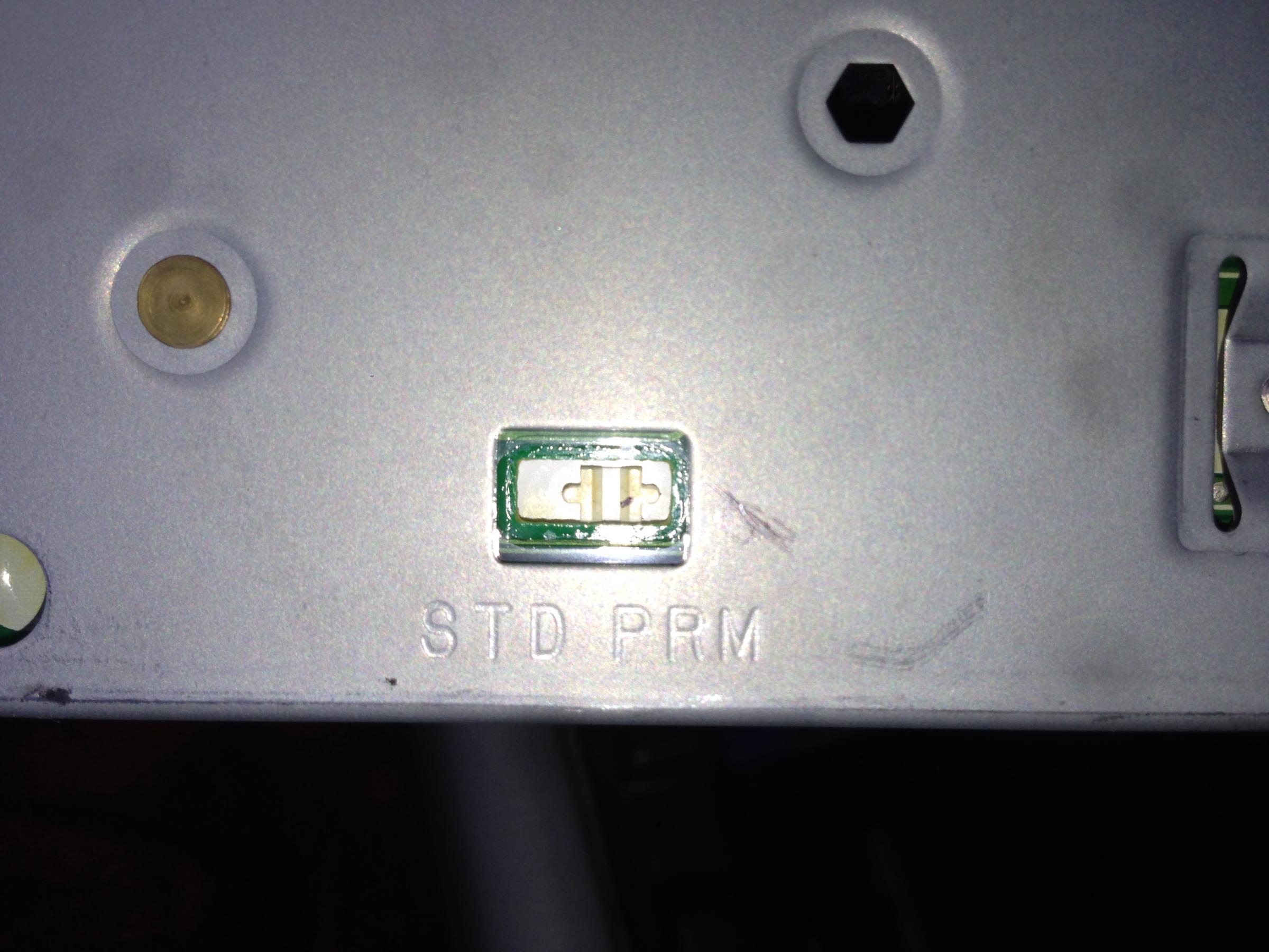

There is a switch on underside of my radio with two option, "STD" & PRM". Not sure if this could change the option of needing a code, but as I haven't touched the switch I have no idea why now out of the blue I now need a code!

There is a switch on underside of my radio with two option, "STD" & PRM"......
The switch to set the head unit for for STanDard or PReMium sound system.
Took a pic of the switch (1st pic), seems I have the Premium set up!
There's not much to these radios when you take them out of the console, just a regular size deck with a nice fancy faceplate (pis 2&3)
