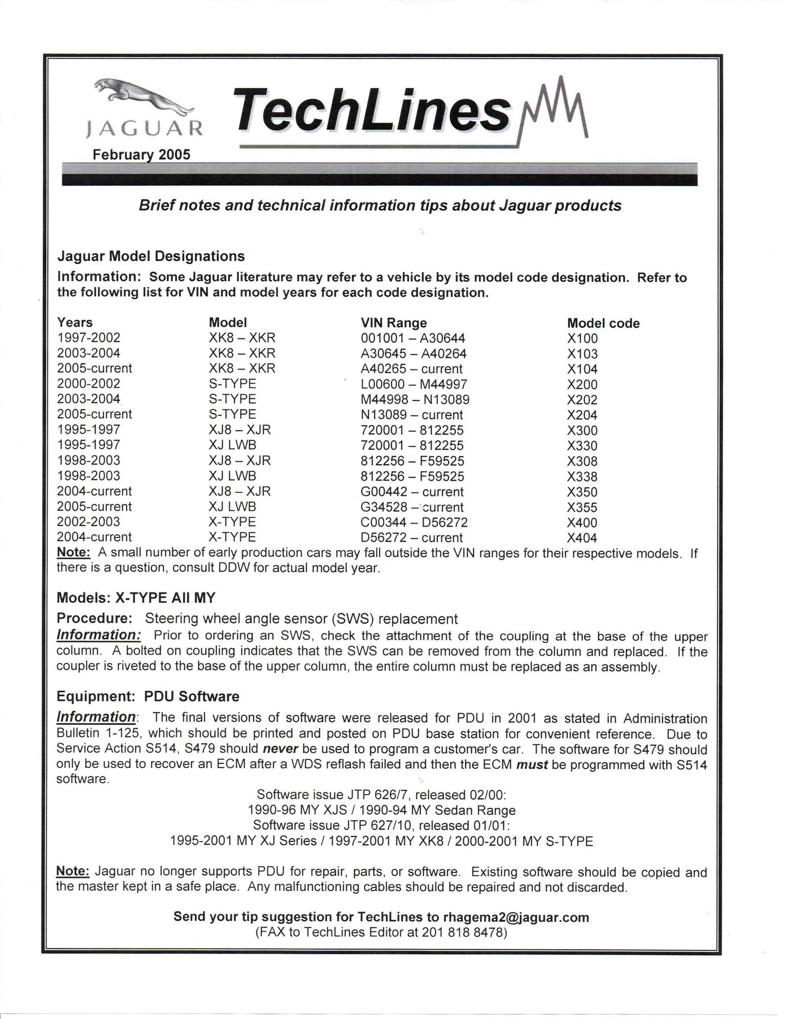

Just a general question. The information label on the driver side door post says date of manufacture is Oct 8,1996
and the previous owner took possession of the car on Nov 15, 1996. This actually makes my car a 1996 XK8 not
a 1997 doesn't it? The serial number ends with 002693.

Thanks for clearing that up. I just bought the car a month ago and I'm still in the
"I'm in love" stage and I'm trying to find out all I can about the old girl. On my journey
around the forums I found a post by GGG that shows a production numbers chart and
2925 XK8 coupes were made in 1996. Because of my VIN number being in that range
I assumed it was one of these and a '96 instead of a '97. After reading the above post
by Jon89 and the VIN ranges shown in MRomaniks reply I understand that my car is
designated as being in the 1997 model year even though it was built and sold in 1996.
