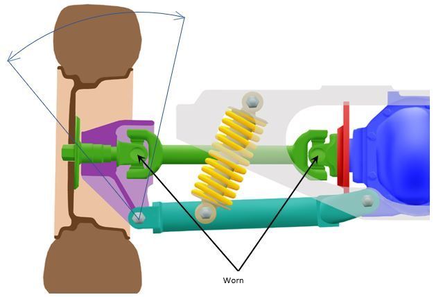

I believe it is possible. Worn UJ bearings will enable play at the wheel in the vertical plane when pivoted at the hub-to-wishbone bearing. See schematic from e-type (same principle).

Cross purposes here, methinks:
Any slop in the UJs (or diff bearings) will allow the length of the driveshaft to vary. Since it's the top link in the suspension geometry, that would indeed allow the hub carrier to rotate around the lower fulcrum bolt.
Any slop in the bearing will manifest at the wheel, and here the condition of the drive shaft is immaterial since as noted, it doesn't offer any support to the bearing.
Might be difficult to distinguish by wobbling the wheel about, but gentle use of a prybar or similar should help determine where the play is?
Q.E.D.

I have a tiny play in my UJ says the MOT man.
As the shaft does not have any splines so is fixed length then play in the UJs would show as in and out movement at the top of the wheel only while play in the bearings would show as play top to bottom and side to side.
